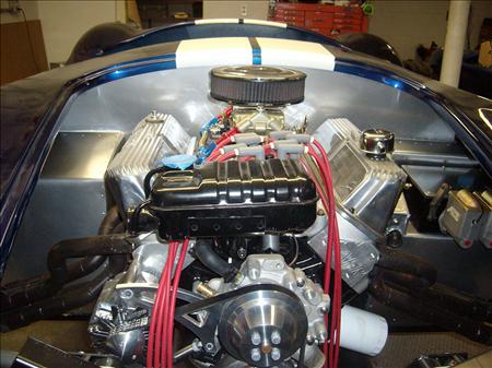

Here is a bad picture of my March set up . It was not the cheapest of course but it is exactly the way I wanted it to look
[/IMG]
