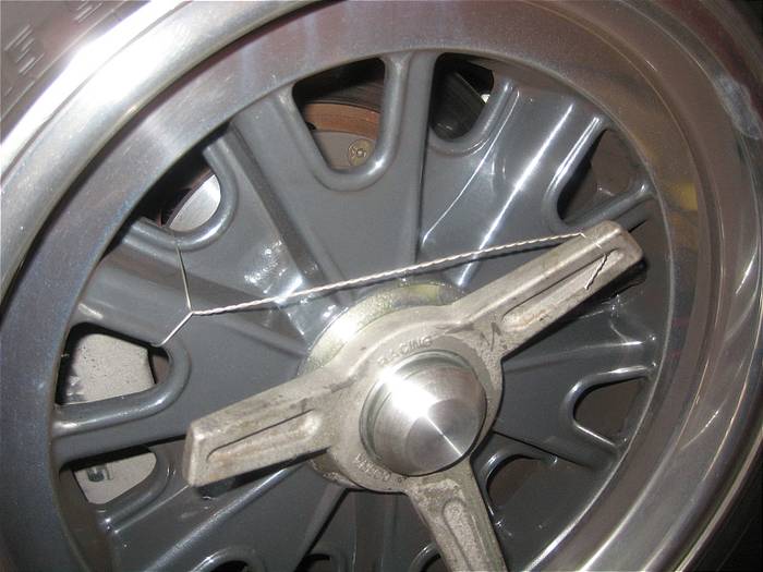

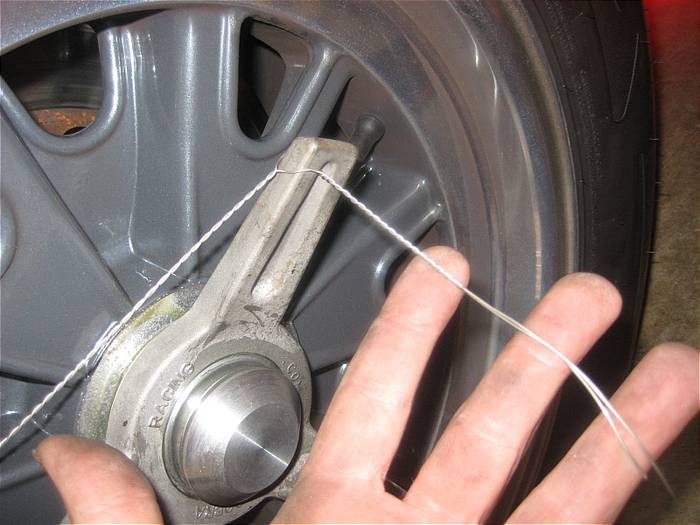

A few days ago, in a thread that I can now not find, a member was commenting that he just couldn't get his safety wire twists to look good, even when using dedicated safety wire pliers. Yesterday, when I was removing a wheel, I thought of that post, so I picked up the camera to take a shot for him. Like almost everything in life, there is a trick that makes it easy to look good. That trick is start your twisting by hand, not with the pliers. Here it is:
When initially wrapping the wire around the spoke of the wheel, hand twist the wire tightly against the spoke. Do a couple of twists like this before using your pliers. This will allow the pliers twisting action to start fresh up against the spoke.
Then put the safety wire pliers on the end and it will perform a clean twist. Do that to a length right up against the end of the spinner; then bring an end of the wire though the drilled hole in your spinner and run a inch or two of twist and cut to an appropriate length.
The finished product.

Nice application Pat, good instructions, but from a working angle and to be more secure the next spoke to the right on the wheel would be a better starting point. It would require a more direct pull at closer to 90 degrees to the ear of the knock off.
But it wouldn't look as pretty.

Remember, for .032" wire (that's what I use), the number of twists/inch should be 7 to 9.

One suggestion to improve the looks of the safety wire a bit further...start at the spinner, twist the wire toward the target spoke, then wrap the wires around the spoke and finish the final twist inside the spoke, behind the wheel. It takes positioning the target spoke where you can get to it, and laying on the ground at each wheel for a short while, but you end up with the loose end behind the wheel and out of sight where it won't cut or stick you. Then inquiring minds will ask you just how the heck did you do that!!?!

That wheel is on the passenger side, so it is reverse threaded. Had it been on the driver's side, the safety wire would be in the opposite direction. Not all spinners are reverse threaded on the passenger side, but most are. Personally, I think you should leave your safety wire tight ... but that's a personal preference and others choose to leave a little slack or "loop" in the wire. Actually, it's easier to leave slack than it is to get it tight... maybe that's why they prefer to do it that way.

I position the loose end of the wire on the backside of the spinners ear. Then bend a "button hook". I have scars on my knuckles from the wire scratching during washing the wheel before I moved to the backside.

If this spinner is a right hand spinner then it's saftey wire is incorrect. If it's left hand then it's correct. I don't own a set of knock-off, but do they have left thread?
