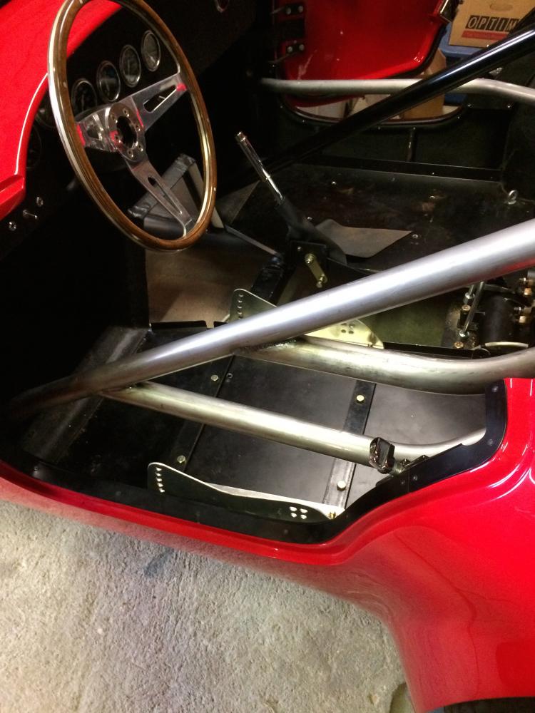

Good luck with your plan. I have not raced mine with NASA, buut this is what I did for vintage racing with SVRA, VRG and SCCA vintage. While yo will not have a passenger, you still may want to consider putting some side protection on the passenger side, and definitely on the drivers side. You cannot control what you may hit, or what may hit you. Even in HPDE events bad things happen sometimes.
Here are some pictures of my roll cage addition to my Superformance 289 FIA. The roll cage was tied into the frame behind the seats and to the hoop under the dash.
The side bars are easy to step over. I have added a second bar on top of the passenger single bar and brought a send bar across from the drivers side to the front hoop.
Hope this helps. Have fun and be safe. Nothing like driving a cobra at speed on a track.

Those door bars look awesome and I would have no issue incorporating something like that into my design, specifically because you’ve still retained 100% of the aesthetic nature of the original car, while vastly increasing car safety. But, and, don’t take me the wrong way here, going simply by what the rule book says about roll-cage design, I don’t see how that would be in any way legal (NASA rules anyway). I mean, obviously it is, and someone has signed off on it, but just judging by the “letter of the law” as outlined in the book, I don’t see how it would be...AND in a nutshell, that’s what I’m finding most frustrating about this journey so far. It seems like car eligibility has less to do with the actual “rules” and falls more on the whims of the local chapter or even possibly the tech inspector at a particular event. Have you ever been given a hard time about your cage setup? Did you get approval and/or design notes from a tech inspector before you built it?

In vintage racing the rules are a little softer around roll cages. Mine is more than is required. I sent the pictures of the roll cage to SVRA (that's where the logbook is) and they liked it. I have raced the car in SCCA vintage races and have not had any complaints. Just reviewed the current NASA rules and could no see anything in the roll cage section that addressed open cars. The rules were designed around a car with a roof. Have you looked at the designs of the roll cage manufacturers that they reference?
My driver's side continues up to the hoop to provide two support points going forward.
