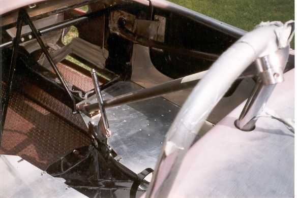

Default Cage in ERA FIA
I had some side braces and a rear brace added in my ERA. There is also a brace under the dash, running from one door post to the other. I also made the center dash braces functional, out of thicker material, and made brackets to tie them into the frame and the under-dash cross brace.
There are a few more shots in my photo gallery.
Jeff
