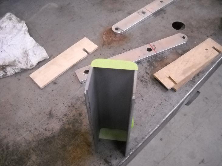

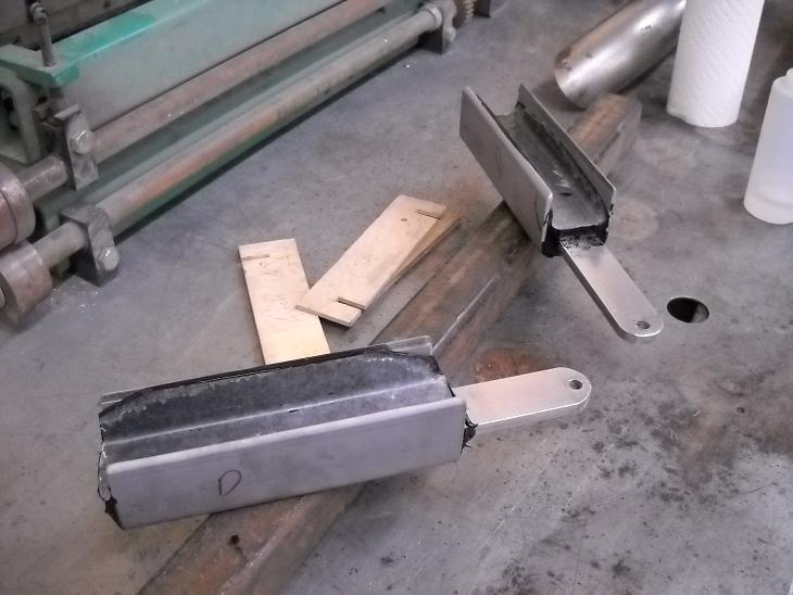

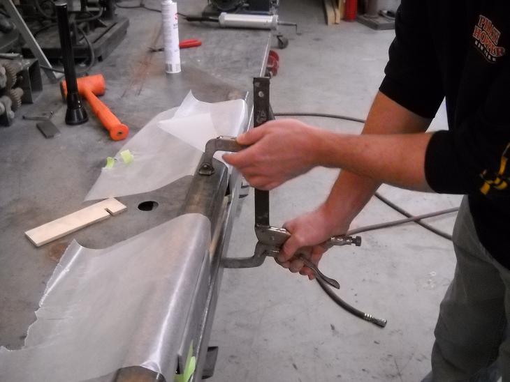

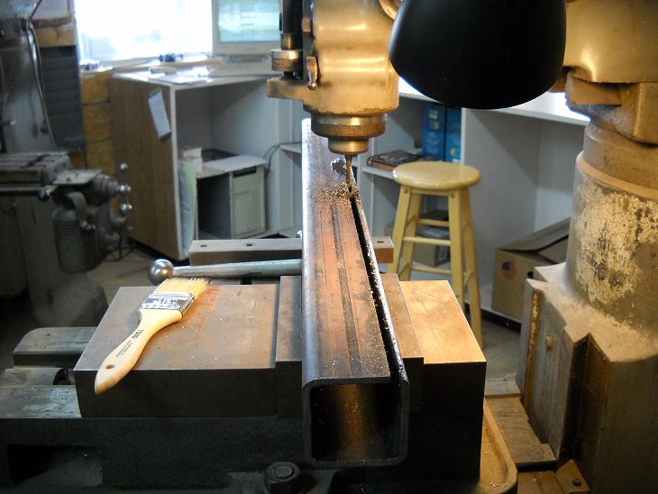

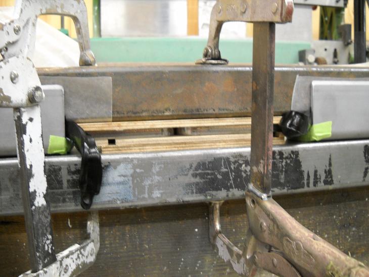

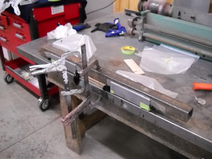

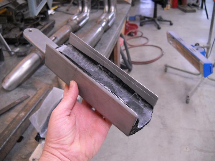

Trying something new and thought I would share my home made Urethane side pipe mounts. I always wanted to make a better set up for the side pipes so they could move a little with the motor and maybe not crack or brake the muffler guts free, so here is what I am doing. I started with a piece of box tube that would fit over the box tube frame out rigger and cut it open into a C channel. If the photos don't explain it let me know and I will go into more details. With any luck I will have more photos tomorrow and will show you how it works on the car.

In a few days the urethane will be all set up and I can do the final trim, paint, drill my holes and remount my pipes. I hope this helps and makes cense if not don't hesitate to ask.

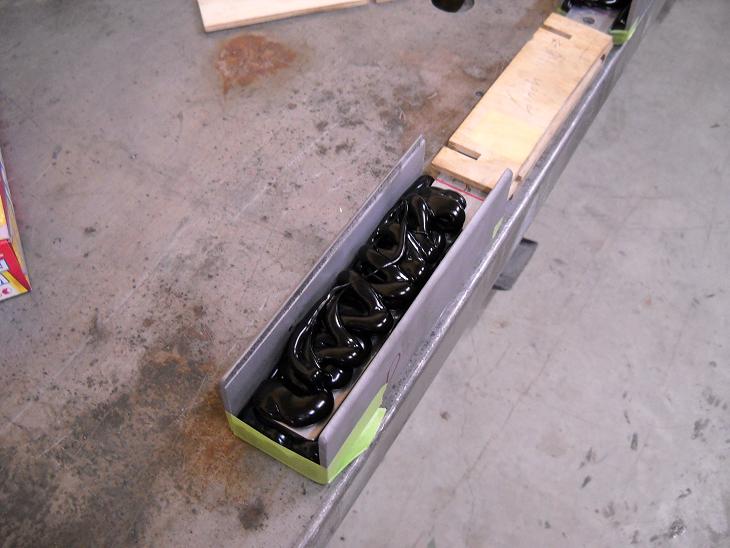

Thank you for sharing! What is the urethane you are using?

I used two tubes of 3m windshield urethane but I am looking into a two part for faster set up.
