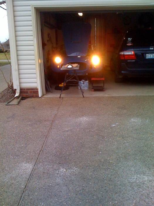

I wasn't happy with the brightness of the sylvania headlights. I even added a relay directly from the battery. I took them out and ran jumper cables directly to the terminals. The same dull glow.
The one that come with the kit are 6014. I am trying halogen h6024. They are the same size. So far they appear to be brighter. Anybody find anything better? That drops in?
The driver side is the new h6024. Seems a bit brighter.
