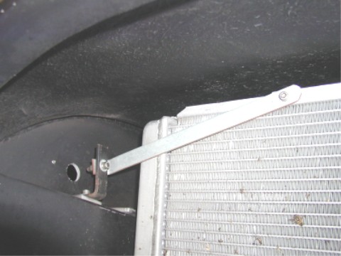

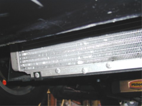

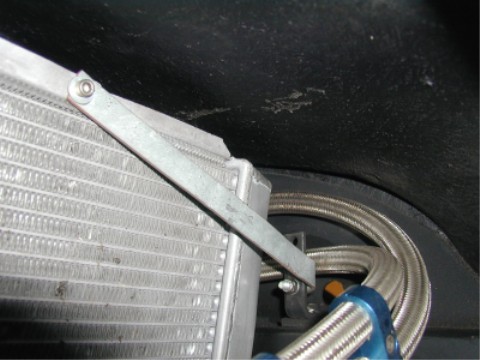

I had Afco build me one. it is an aluminum racing rad, standard Ford size 19 x 26, AN--16 fittings, blocked off the filler cap and installed a petcock drain. Total cost was around 250.00.
I originally had a Griffin but it leaked at a bad weld.
I layed the rad in the A&C lower mount and riveted and/or bolted some flat stock to secure the top. Been on for years. No problems.
