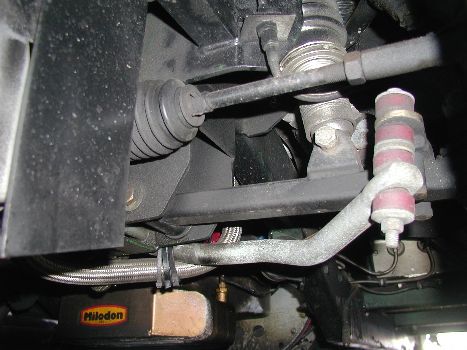

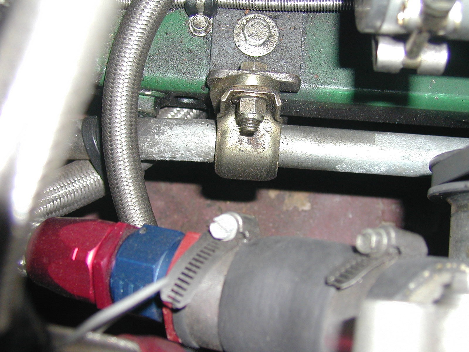

I've got a 1" sway bar in the front. I'm sure it's improved the handling but I did it from the getgo so I can't say how much.
Here you can see it attached to the crossmember
And here is the end attachment

What I was thinking was something more like Roscoe's. It doesn't look anyone makes a setup which will just bolt on without some fabrication. Roscoe I like those brackets that bolt on to the sway bar mounts. Did you fabricate them or does someone make them? Pending that it sounds like my best bet is take some measurements and then call Heidt's see what they have that's close and use that as a starting point..

Those mounting brackets came with my swaybar. I may have fabricated the 'L' brackets.
