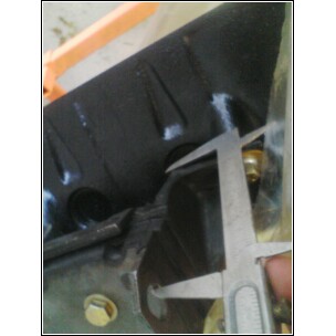

Good question, actually I don't know unless someone can tell me what the differnce in height is. I'm running Prothane mounts I got through Summit.
http://store.summitracing.com/partde...5&autoview=sku
I can tell you with my moroso pan it's barely below the frame. The bell housing is lower. I'll try and take some picture and try and get them posted tonight..

Ok I measured my motor mounts at 3" vertical height. There a photo of it in my gallary. Is that a high or low mount?

This is a tall 351 mount the bottom of the caliper is in the top of the hole 3 1/4". Not sure what the short is. Looks shorter on the mustangunlimited web site.

Here's a couple of shots of my mounts. Don't know if they are short or tall.
http://www.priveye.com/cobra/Mount4.jpg
http://www.priveye.com/cobra/Mount3.jpg

Hi Ron, I'll try and make the same measurement tonight. I checked Eldbrock website and the difference in height is 1 1/8, between the RPM and Air Gap..

Ron, I measured my mount hte same way you did and it is high mount. Now we just to figure out how much we would save using a low one..
