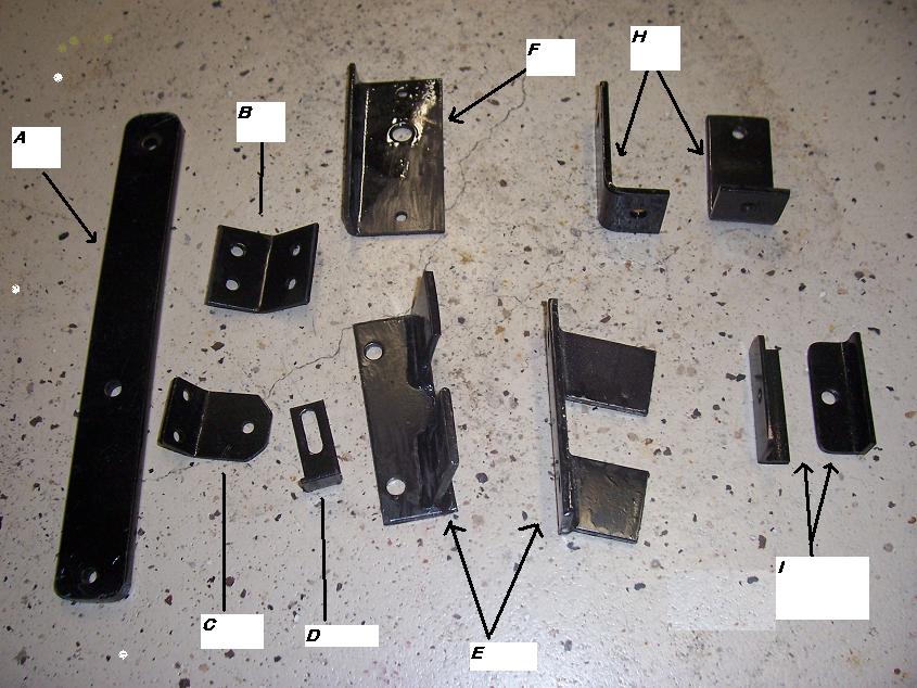

Getting down to the end of the parts. I haven't mounted the windshield yet. I am guessing most will go there. I did attach the cowl frame so some brackets are gone.
Any guess? I think A is the sidepipe mount I hope it is since I used one for the left pipe. H is a windshield mount bracket.
Thanks for looking.

What are I for? I have them left over as well

A- sidepipes
C - hood rod holder
D trunk latch
E - back door latch holders
F - trunk handle holder
I ??? I had left over

Thank you. I had no idea.
I I wonder if it was supposed to be welded to the sidepipes and bolted to A???

I got stainless pipes and had a stainless bracket welded to them to bolt to btacket which goes to frame.

I: Side pipe mounts. You weld them on the side pipe and then mount them to A.
So your incling was right.
