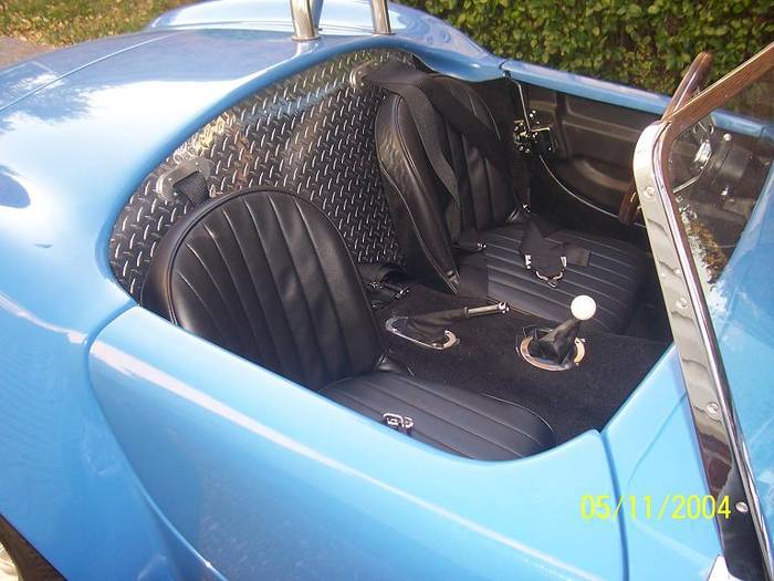

Did the carpet install yesterday. Went in easy. Anybody have tips for installing the side pockets on the door. clips? screws?

Hey, i tried glue first and it didn't workout as well as i wanted to. So i got some 1/2 stainless steel screws and mounted them that way. did pilot holes first. Looks good.

Stainless Steel screws with Stainless upolstry washers (4) per panel (no glue).

Don't use washer they will cut the viynil. Lowes or home depot sell 1/4 inch plastic push anchors. They have a factory like finish to them when your done
