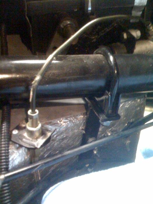

do you have a picture of "B"installed?
Here's the bracket. I thought too it was the cowl bracket. Ha. Wasn't that long ago. I have a flaming river steering column. You can see the muffler clamp goes thur the bracket. You mount it to the side of the foot box.

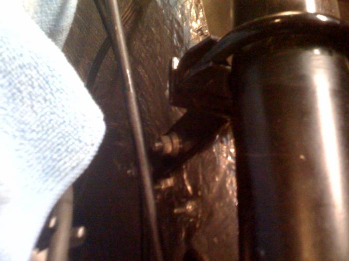

Here is C right in the middle.!!!!!!
