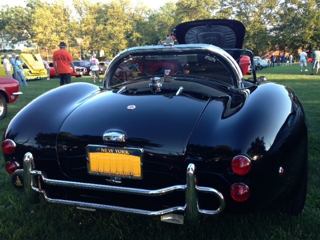

I agree with you wholeheartedly, my car has the full with roll bar and I love the look and naturally, its functionality. I guess that back when the Cobras were thoughout were only considering the driver, times have changed since. See my rool bar picture below.
Lou
