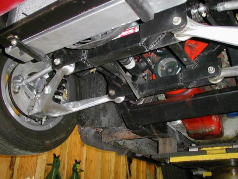

cdcofer, thanks for the kind words. My front clip was built to slide into the existing frame rails.
Just to the left of the oil pan is the new joint of the old level frame and the new angled frame.
http://www.clubcobra.com/photopost/d...ght_front4.jpg
I inverted this picture so you can see the frame in the correct position. The level pieces to the left slide into the old frame. The radiator sits between the wide level pieces to the right.
http://webpages.charter.net/howley23/frameclip1.jpg
Arthur, I was never happy with the MGB suspension. The new suspension performs 100% better. Rat_rod_Russell has done a better job of fabing the a-arms to the frame. He put them at the correct front to rear angle where as mine are level. That angle would change the castor with wheel rise and fall. I don't know what difference that would make.

Tom, Great job on your IFS. Did the track width change? Any problem with connecting the steering column?

Tom Howland 12-03-2006 08:42 PM
Arthur, Yes the front track did change. I’m about 3 inches wider. I think the fabricator for the front clip did not take into account the set back difference from Corvette wheels and regular wheels. I am thinking of changing the spindles or hubs if possible to reduce the 3 inches. I am running old BFG’s that are 25.5 inches in diameter, which hit the rear of the left wheel well when turning left. I can live with it now but I need new tires and all the tires I like are 26.5 inches in diameter.
The new angle on the Sweet steering rack necessitated grinding on the u-joint to allow it to rotate. Other than that it worked out OK. Same location.
Thanks for the info on Anti-Dive, I wondered about that.
