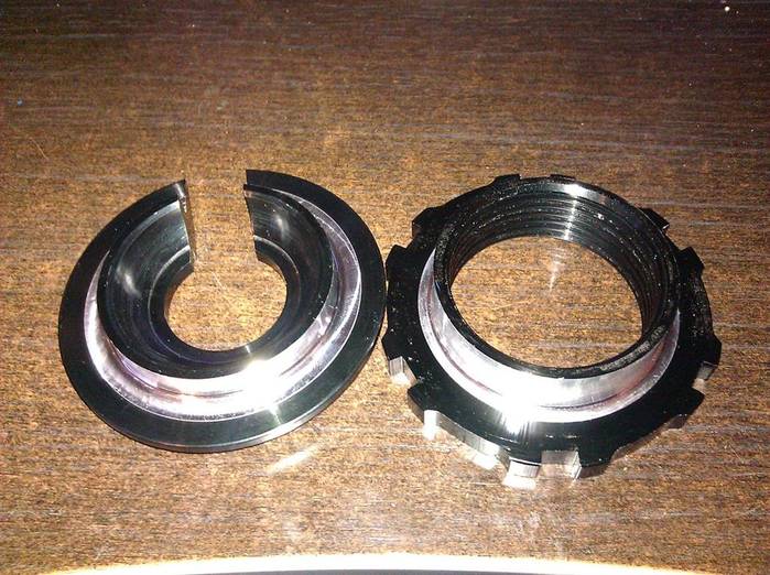

Dennis, have you got new style cr front end or previous, any pics with the shock fitted ?
Merv
Heres a pic with DS401 and a 2.25" spring, with machined seats.
Machined Seats
appears to be a common mod on the 4x4 and nissan forums, the 4x4 are fitting spring rates up to 750 lp

Yes Dennis, that is a good idea. I could trim the seats down to fit the current springs. I was looking at some machined seats that Murray had made for his Harrison QA springs yesterday for 2.25s. He made them in steel however.
