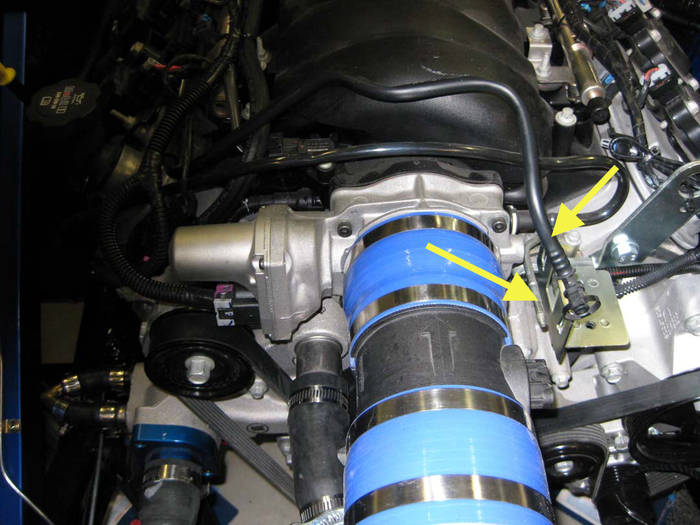

Almost ready to fire it up, just finishing a few details. There are a couple of pipes I've highlighted in the image. Can someone please tell me what they are for - I suspect they are breathers that were originally connected to the air cleaner but I'm really only guessing.
Peter

where does the other end go?

Little metal one is a steam pipe - plump to your header tank or radiator, the other looks like it is your crankcase breater - in a stock setup that runs into your air intake somewhere after your filter.

I can vouch for the steam pipe Peter but not sure about the other one.

Thanks guys - great help as usual. The black pipe goes to the left rocker cover so Tenrocca your suggestion that it is a breather sounds spot on.
Peter
