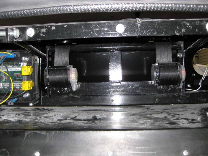

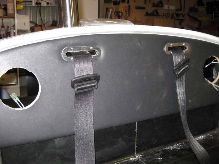

Mick
I did exactly as Bruce suggested - cut out the 'glass and then mounted the reel in reverse, using the same tab. I then glassed a box around the back of the belt. You will just need to be careful of the handbrake assembly - I ended up having to change some of that as well.
A couple of photos should tell the story.
Geof

Default New Belts
Mick
If you do mount the reels up high, just be aware that you will either need new belt assemblies or you will need to get the ones you have shortened, as the reel won't retract all the necessary belt.
Geof

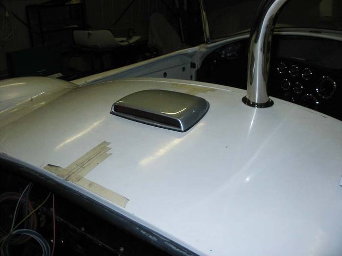

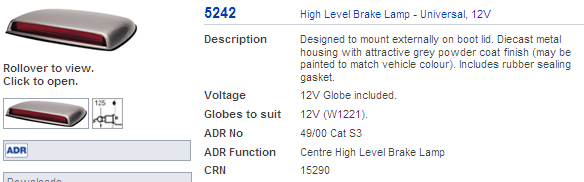

Posts: 1,440
Pecal,
if thats a third brake light light mounted on the body in the last picture, could you let me know what type it is and could you post a few more snaps please?
Regards.
Mando
Old 12-07-2009, 01:12 PM
Join Date: Feb 2008
Posts: 110
Hi Mando
The light is a Hella - Part No 5242. You can get them from Bursons for about $90.
Peter
Old 12-07-2009, 01:34 PM
stephen low's Avatar
Join Date: Aug 2001
Posts: 2,304
I've the same one Mando and with stripes they tend to blend into the paint sheme a fair bit.
It's one of those safety items I do like, to try and keep the nuff nuffs out of your boot.
Particularly as I don't think the normal brake lights using a Lucas version are either particularly effective nor looked at by following traffic for these cars.
slowy
