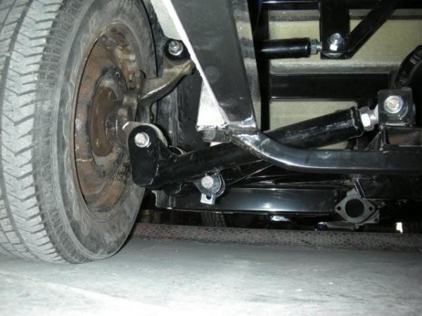

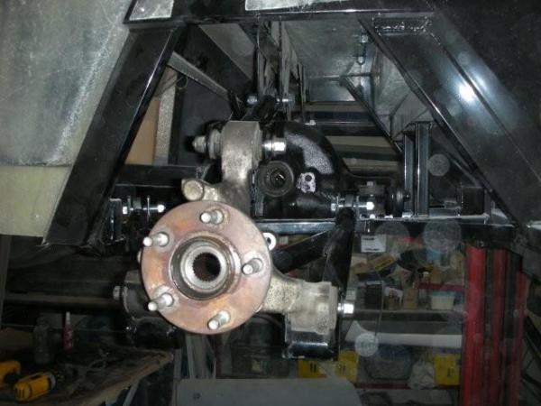

Looking good TL. That's not the standard Nissan rear end I see, have you gone for the Commodore IRS?

T.L. if your rear end is Commodore IRS suspension does that mean your car will have dish on the rear wheels? Bye the way I love those AP Brakes!
Regards.
Mando,
When looking around I went to Warwicks and saw the Factory Five type setup and saw a few benefits from doing the rear end from there. Warwick had done one to a Daytona so I grabbed the opportunity and ordered mine with their setup from Warwick.
It's a Lincoln Continental Mk8/Thunderbird SuperCoupe/..... rear that uses a Ford 8.8 IRS. The one I got had drums (  ) so I had to source a few more items, but I am happy with what I am seeing progressing so far. The knuckles are similar to current Mustangs and I have put some Mustang hubs there with 5 @ 4.5" as the ones I had were 4.25". The rear brakes are also standard Mustang with the handbrake setup onto the caliper through the brake piston, and the axles are beefed up to handle a bit more grunt, even if I don't use it.
The wheel will be there with a deep dish, 4.65" backspace, so I should have a nice deep dish look on the car.

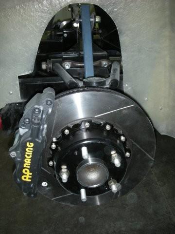

The AP Racing calipers were the first thing I purchased, and look mean. Only 4 pot, but I felt that that was enough stopping power for a car 1100kg's or thereabouts (1200 with me in it).
I have put a Torsen 2 lsd in the rear, as it was an open diff, and it has 3.27 for the gear ratio. I will keep it at this as it should mean 2200 for 100kmph.
At least 1/3 of the driveline is Ford!!!!!!!!!!!!, and it's the last part before the wheels

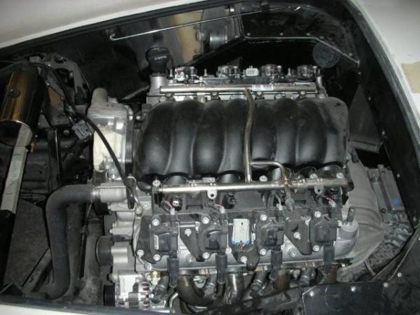

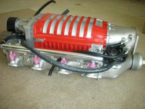

See above for rear end comments, and yes that little thing is a puffer for the top of the engine. It sits there quite nicely and according to Harrop/Walkinshaw, it will do 470kW and 750Nm onto my engine without having to do anything to ends or heads or .......only runs larger injectors. The ultimate in Bolt on performance if I say so. It looks the business on top of the engine as well. Had a few issues with fitting after they missed out on including a main part, but all go now. It's too much power I know, but then my right foot is extremely light, and law obiding for the 'others' who look at these forums.
I will be running some form of traction control, as I have the ABS unit and wiring loom from a VE so I'll see how that goes. If all else fails, take it off and put the normal intake on, and put the S/C on my everyday car

Nice work TL. Although you can never have enough dish on the rear, I reckon it's the fronts that could do with more frontspace / less backspace. It certainly limits wheel selection, at least in my experience, with the Nissan IRS geometry no problem for most wheel makers to accomodate.
I'm interested to hear if TCS can be fitted because my Harrison is VZ/VE based and my Nissan diff has the ABS wheel speed sensor plug on the pinion housing. Please share any findings in this regard!

Those Pink injectors look a little Gay
470KW you would have thought they could have supplied some more manly colored injectors.
Sambo,
I know what you mean about the fronts. I have the Commodore fronts and have had to use the smallest dish possible, and even then I will be flaring the front guards out a small amount to keep the wheels and spinner under the guards and not look like some goofish thing used to slice tyres open.
I'll let you know on the ABS issue as John Cini will be doing that. We have the rings so far and I know that John and Sideshow have been talking about this as well. I'll let you know.
Mike,
Yes they could be a better colour, but they will be hidden by the cover anyway. I'm not worrying about relocating the coil packs like you did, so I have a nice cover to go there. Current plan is to paint that the same colour as the car. The whole thing looks pretty mean when seen outside the car.

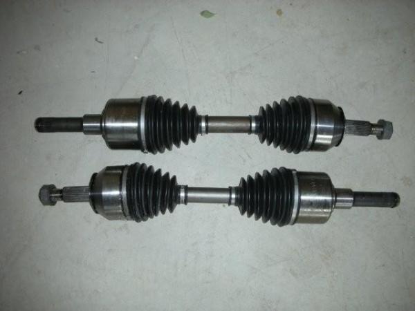

I heard about axle issues with the FF5 guys on their forum and got some beefier axles for the car. These ones are 33.8mm dia (1.330" old school) so should hold up well to an axle breaking issue. I think I will have trouble with keeping the tyres from spinning too much, (315 wheels will be on there) but it comes back to how the whole geometry is set up. If its set up bad, then bad things will happen, if it's set up good, then it should all go smoothly. I'm hoping for the smooth option.

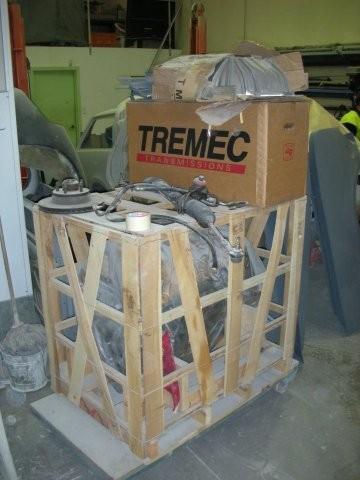

Hi Wazza, I'm curious about the T56 you intend using. Knowing the type of guy you are and seeing the type of work you have done on previous cars why have you chosen the T56 instead of say a Tremec 600 or similar?
Regards.
Mando
12-23-2009, 02:42 PM
Join Date: Nov 2006
Location: Gold Coast Queensland,
QLD
Posts: 1,683
Hi Mando,
Sort of wandered into it a bit !!
Had originally decided I wanted a 6 speed...
I like the long drives on the open road, so the overdrive gears get plenty of work.
Had a Tremec TR3550 ( 5 speed ) in the previous Cobra, and although the 347 Windsor stroker had tons of Torque, and pulled well in 5th., I always said it would be more driveable with an extra gear .
Driving along in 5th. on the highway, I always found myself creeping up to around the 130 k.p.h., so that it would be smoother to drive.
Sometimes sitting on 100-110 I would be "chugging" a bit and need to pop it back into 4th.
That was my excuse for speeding anyway...
Looked at...and WANTED ... the Tremec TR6060, which was described on one website as a T56 on steroids.....
Thought it would be a nice match up with the LS7, and wanted all the "links" in the drive train to be very strong.
I want this whole thing to be put together just ONCE, and not have to go back later to upgrade any weak links in the car.
Been there done that..over it!
Spoke to Mal Wood..
http://www.malwoodauto.com.au/
and he insisted that his "Beefed up" version of a standard T56 would be perfect.
Extra Sincros and some stronger bits installed, to take as much H.P. and Torque as you could throw at it.
I also asked for the gearshift to be centre mounted (rather than the standard rear mounting)to get the stick out from under the arm, and into the right driving position.
It also seemed like a sound idea to also use the same box that the Z06 Corvette uses with the LS7 engine.
