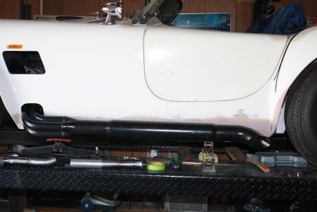

IF...I was going to put side pipes on my car and they consisted of four 2" collector pipes, a 3 foot glass pack hot dog muffler (3" ID) and a 3-1/2" outlet. (Which is a copy of the original set up.) I can imagine this set up would be a little loud. Can anyone suggest additional "muffling" to add to the pipe ?
Please be assured that this is only a theoretical question. I don't have these pipes I just would like to know how to make them quieter !

For a stock 351 3"id is too big and of little muffling value. Check out reverse flow chambered mufflers or cobra pack 2 1/2" spiral louvered mufflers.
You can get the spiral louver made here in Australia to whatever length you want.
Too big is not always good you will want to keep the gas velocity up to assist in extracting the next pulse.

see what I mean

Rob, this product looks interesting.
http://www.spiralturbobaffles.com/musclecars.html

Thanks Sambo...they look simple enough to build a couple and play with them to make less noise.
The owner is smart he says they are 'tuneable' but doesn't say how. I can imagine it's by lengthening or shortening them. As far as noise reduction the yanks seem to have a different idea about the sound of a V8 and sound levels compared to what we are allowed.

Rob, If you can graft a cat conveter into the collector it would help.
I have a home made 4" outer with 2" perf tube and had to fit a mini version of the spiral to sit in the 2" to get through rego, though I only had to comply with 96dBa

Dave you've read my mind....I'm also looking at 'Car Chrmistry' muffler inserts and 'Aero Tech Turbo Flow' designs to build and insert inside the hot dog.

Summit Racing have a perforated cone - see their exhaust section.
www.summitracing.com
This I am told breaks the exhaust up. The total area of the holes equals the internal diameter of the pipes which does not restrict flow.
