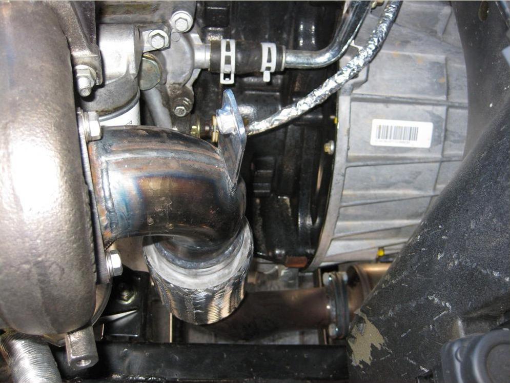

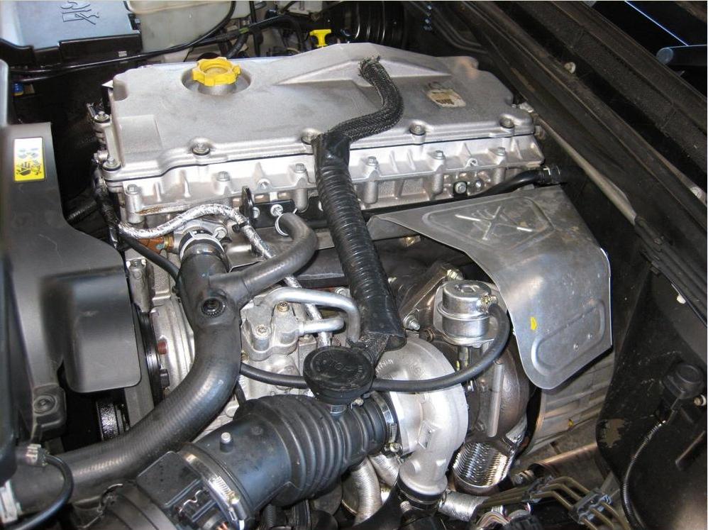

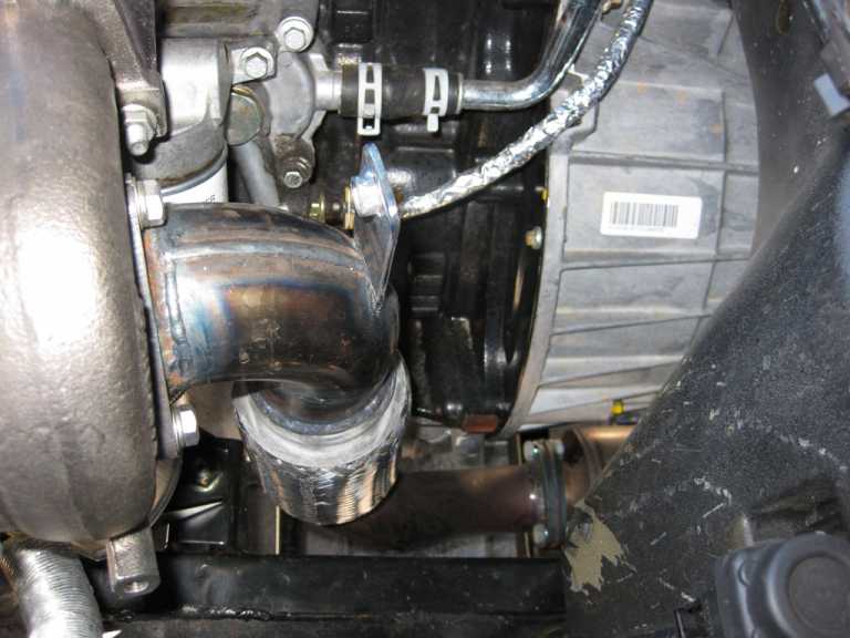

For loom that runs near hot stuff I then wrap it in aluminum flashing tape. This is self adhesive backed and available from Bunnings. I used this on my land rover for all the wiring that ran near the turbo and exhaust. All the original conduit and tape had been dammaged by the heat and even the wires looked a bit worse for wear. The flashing tape reflects a bit of the heat and should protect the loom underneath.
You can see it here where the oil pressure sender loom runs past the back of the turbo:
http://www.clubcobra.com/photopost/data/500/TD5_2.JPG
And here where the A/C loom runs near the top of the exhaust mainfold.
http://www.clubcobra.com/photopost/data/500/TD5_1.JPG
I've probably got some spare aluminum tape if you need it.
