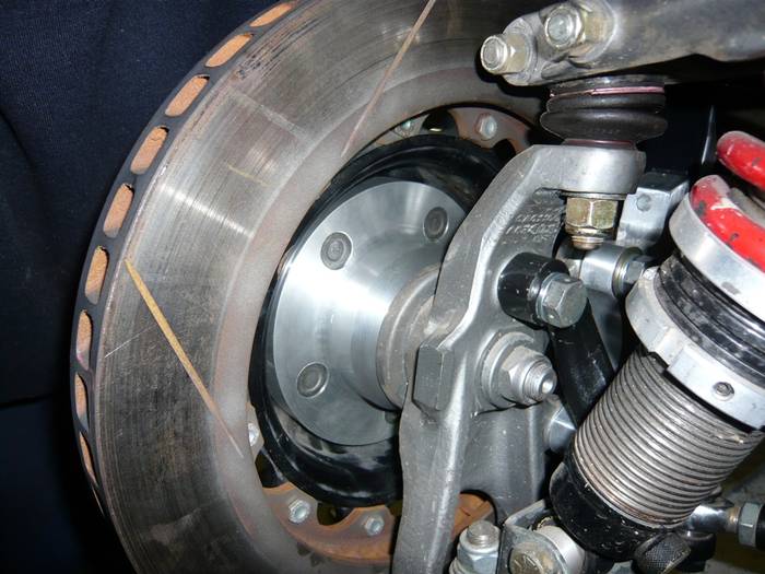

You can have RDA/EBC ventilated slotted and dimpled, or DBA slotted (not sure about cross drilled), or you can switch to Wilwood and go with a 2 piece set up with just about any disc you want. What other other options would you want?
Or you could make your own

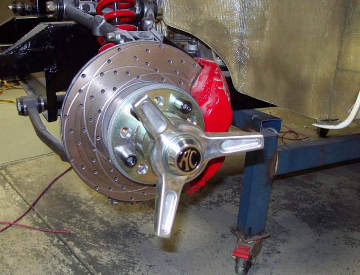

Not often I find time to sit on the Garage Floor and play around with the Cobra.
RDA slotted rotors and a tin of paint. EBC Red stuffs to be fitted when I next find time in the Shed

Old 07-18-2010, 03:57 AM
PCC's Avatar
PCC PCC is offline
Join Date: Sep 2003
Posts: 1,431
PCC (Peter Craig)
Keep the sun shining
Old 07-18-2010, 04:56 AM
Aussie Mike's Avatar
Location: Sunbury, VIC
Looks Good Pete! I'm hoping to get some more shed time myself now.

Originally Posted by PCC View Post
If you paint them red your car will stop faster

Old 07-18-2010, 06:01 PM
LB
Yep, Red definitely stop better. I had red ones on mine initially and it never even moved out of the shed. How's that for stopping power!
These brakes are now on Bobby Brown's G Force.
