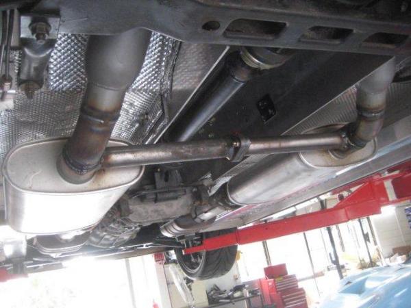

paul68 11-06-2010 04:10 AM
Dave mine sounds the same as chris's car,i ran them the same as your build cd cd shows.The exhaust should be no problem.Here's a photo of Peters exhaust as mine is in the exhaust shop till monday or tuesday.http://www.clubcobra.com/forums/pict...d=4504&thumb=1
you can see the brake and fuel lines in the corner
