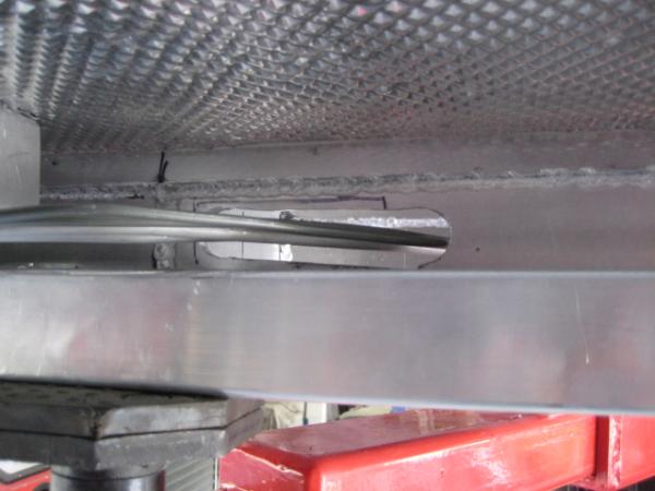

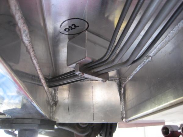

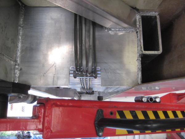

I have been advised by Wazza to fit the brake pipe work first (hard lines) Does anyone have a picture showing where the routing goes under the body?
I think it is mainly the rear ones (showing where to fit tab for flex pipe) I will need an idea on as I can see pics showing the front and I managed to take a pic of Paul's car in Isa showing its location at the front.
Pics of progress after Saturday.
Also any other DRB540 builders out there (posters or lurkers) can you pm me as I would like to get in touch to bounce ideas around.

paul68's Avatar
Join Date: Feb 2009
Location: Mount Isa, QLD
Cobra Make, Engine: DRB 540
Posts: 90
Default brake lines
Old 11-03-2010, 05:22 AM
paul68's Avatar
Join Date: Feb 2009
Posts: 90
Default brake lines
couple of photos hope they help
Old 11-03-2010, 06:36 AM
boxhead's Avatar
Posts: 5,699
Thanks for that Paul, much appreciated.

Started on the assembly today and checked out all the bits I have, I must say the kit comes with alot of brackets and plates that in my case I had to make during my Cobra buid.
After a quick look at the brake pipe routing options I have realised that this car is different to the one in the build manual (in relation to floor shape- which in turn changes how I need to route the pipes), in the following pic you can see the 2 options I have for routing.
In the above picture, the red line shows routing of brake pipes as per manual, in the manual the large square section chassis rail is not there, but the brake pipe routing follows where I have put the green line.
An option is to run it up inside the wheel arch (after cutting out a piece as per blue square) and follow the routing of the brown line.
The other option (my preferance) is to cut a piece out of the fill in panel between square chassis rail and floor.
In following picture you can see the filler panel between chassis rail and floor.
And follow the routing as per the green lines in first picture.
This then duplicates the routing as shown in the build CD
Can anyone see anything wrong with this thought?

dave my early build cd shows the brake lines run like this hope this helps

Hi Paul,
Your manual CD must be later than Chris's one.
How yours are in the pics is where I had wanted to run them, just not real sure how much room would be left with exhaust fitted.
Here is the most the picture from build CD I have that shows routing in this area.
The pipes appear to "cut through" where in Chris's car`there is a square section chassis rail over the top of the area that the pass through.
