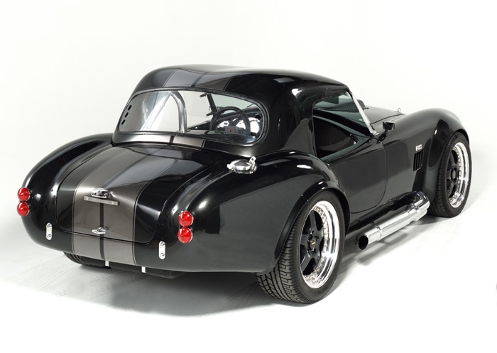

This is a raw version of one similar to the Harrison/RMC that I am considering making up:
Another view of the Le Mans style which has good window fitting:
And one with "Dan Gurney" type bumps!

For those interested in more photos of the DB Replicas hardtop, I've created an album on photobucket.
http://s376.photobucket.com/albums/o...amps8/Hardtop/

Yes customs can ask for proof of payment to verify the price of goods and I have had to provide that evidence in the past on shipments.
Just be careful as you can incur other costs on importation. If there is unexpected costs at this end due to additional inspections from quarantine etc, the freight carrier will pass on these extra charges to you. Sea freight seems to be more susceptible to these charges from time to time.
Nice hardtop though.
Always loved this hardtop. The best by a wide margin. sambo, keep us posted on your satisfaction if/when you get it.
Given you won the argument with your wife about the saddle.
Edit: Any idea what that rear glass is from?. Custom made?.

Yeah custom glass Les. Good news, just sold my old daily driver so the roof will be ordered in the next week or so. What horse saddle?!
