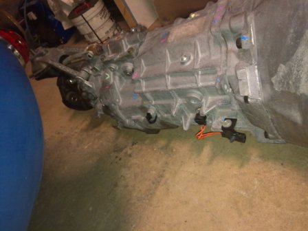

I just picked up a T56 for my cobra and im trying to identify what ratios it is.
I was told it was from a VE SS 6lt Commodore. The id tag has been broken off and the sticker peeled off. Sounds a bit dodgey but i dont think it is.
The gearbox is the type that has the shifter on a bracket off the back of the box. Does anyone know how to ID it without the tag? Surely they dont make the only id on a removable tag. I know i can work out the raito by rotating it, but it is hard to do that acurately.
BTW there is a TUET number printed on the side but i cant quite make it out. It looks like TUET8391 or 8381 but these arent shown on their website.

has it got a speed sensor in it?
www.ultimateconversionwiring.com.au
_
Old 01-30-2011, 02:18 AM
Zedn's Avatar
Join Date: Jun 2009
Location: Sydney, NSW
Posts: 1,640
Hi Doubledip,
Im not sure. It has a sensor on the passenger side at the rear ( is this it?) and then a sensor towards the front on the driver side (reverse?). Do these boxes have a neutral sensor?
I found a post on another forum stating that this was what is in the VE. Can anyone confirm? This is not shown on the TTC link.

Going on your pics, that is a VE T56.
Reverse light switch on RHS front and VSS at rear.
Gary

Guys know its a T56 and i know is from a VE. What i am trying to confirm is the ratio. It has no tag on it.
Old 01-30-2011, 02:22 PM
joyridin''s Avatar
Join Date: Feb 2009
Posts: 1,696
That is the easy part. Drop it in first, count the input vs. output turns. Do the same in 6th. You'll know what the ratio is real fast. Without a tag, that is the only way to do it.
My guess is it will have a .5 sixth gear ratio, which gives it a 2.66 first according to the chart, since just about all the T56's with that input output spline count have that ratio.

Well i discovered why i couldnt figure out what it is. It is a TUET8381 which is not listed on the TTC website or any of the other lists floating around.
I emailed TTC a few days ago and got a response last night. The ratio is different to all the boxes on the list:
1st = 3.01
2nd = 2.07
3rd = 1.43
4th = 1.00
5th = 0.84
6th = 0.56
