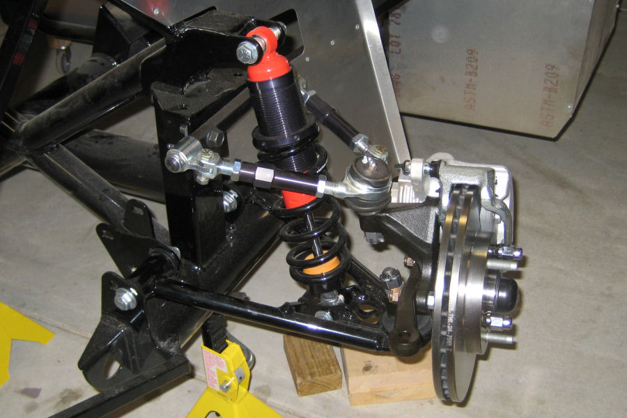

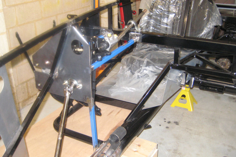

So getting on with the job proper, I started with the front end by properly attaching the forward alum panels and fitting up the front suspension.
http://www.clubcobra.com/photopost/data/500/ffr005.jpg
http://www.clubcobra.com/photopost/data/500/ffr006.jpg
http://www.clubcobra.com/photopost/data/500/ffr007.jpg
Was relatively straight forwards with no real surprises. At this point I had not yet removed the cockpit aluminium.
For interest, the front end geometry on these cars is based on the mustang IFS from years around 2000. It is however modified somewhat with different length A-arms to the mustang to improve on bump steer etc.
As you can see, it is also quite adjustable.

Not sure if the kit specifies, but to me it looks like your front shocks are upside down.
Jethrow 07-28-2011 07:22 AM
Thanks boxhead for the comments. Ref the shocks, they are correct as per the destructions. I also thought it was better as shown as it helps to keep the main seals from drying out, as the internal oil will sit against the seals.

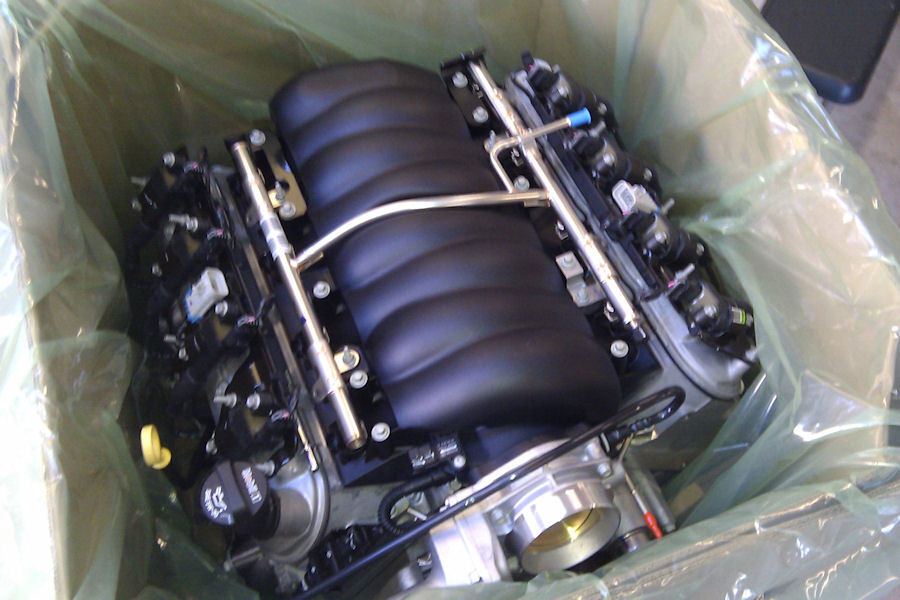

Now not to upset the purists out there, but I was keen on putting in an LS1. I already had one in my Clubsport and was very happy with that engine so wanted to do the same. Also the fact that compared to the twin cam Ford motors the LS was lighter, and smaller did not hurt.
Anyways, whilst doing some research, reading adds etc looking for a suitable motor (I was keen on a low km unit) I realised this was not going to be so easy. So then I thought maybe I should expand the search to include the LS2 as well.
Of course once you realise what the market is asking for a low km LS2, I said bugger it, and ordered a new LS3 from CAPA. And I am very happy with this indeed.
Along with that order, I also got a new TR6060 gearbox along with a clutch, flywheel, slave cylinder, ECU etc etc.
http://www.clubcobra.com/photopost/data/500/ffr015.jpg
How the LS3 arrives - they pack it in cardboard!
I think this has been a good direction as it does mean that for the most part, my car will have been built from 100% new parts and materials.

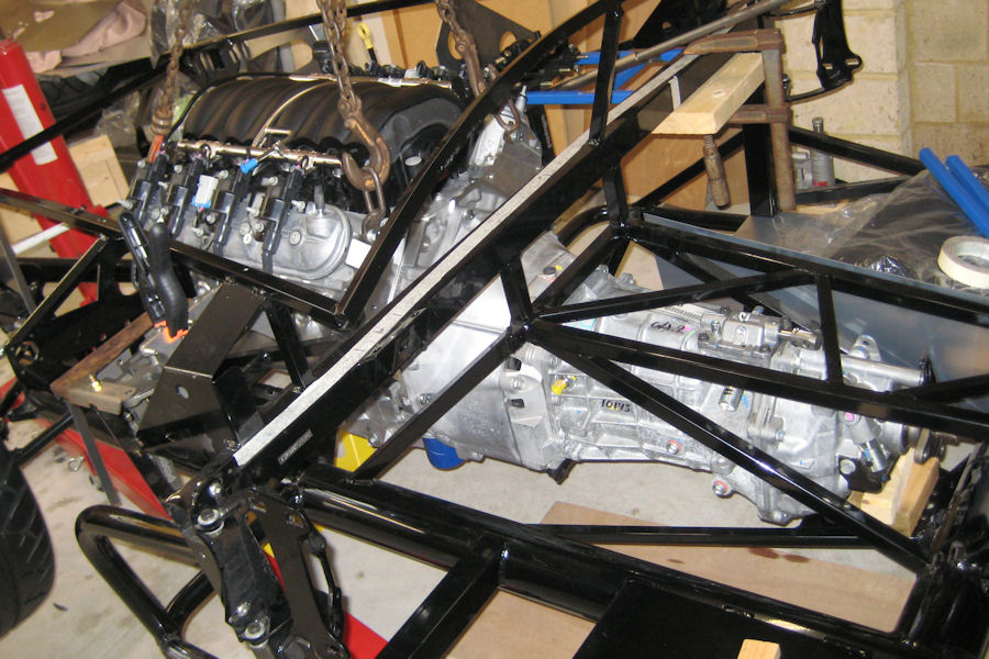

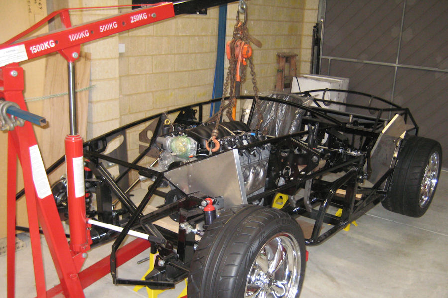

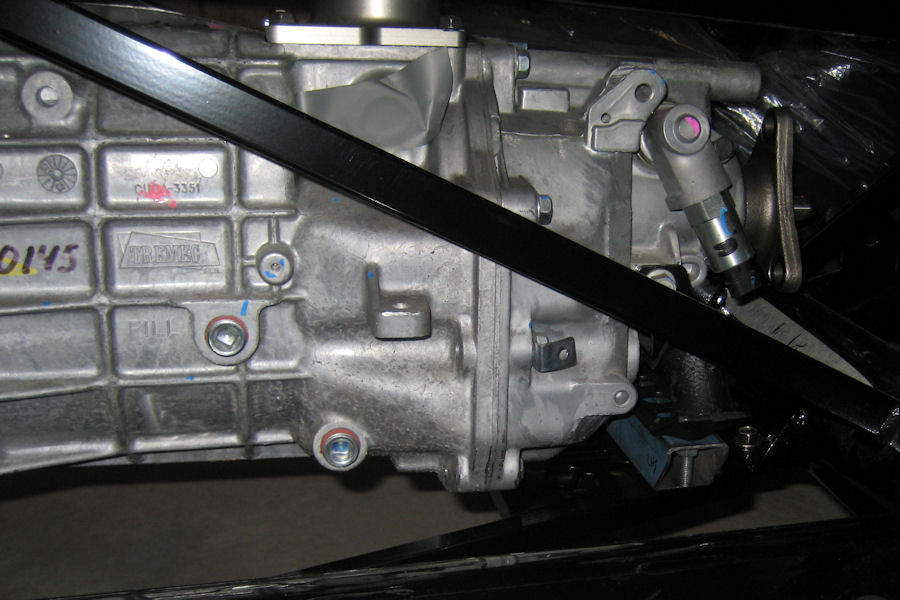

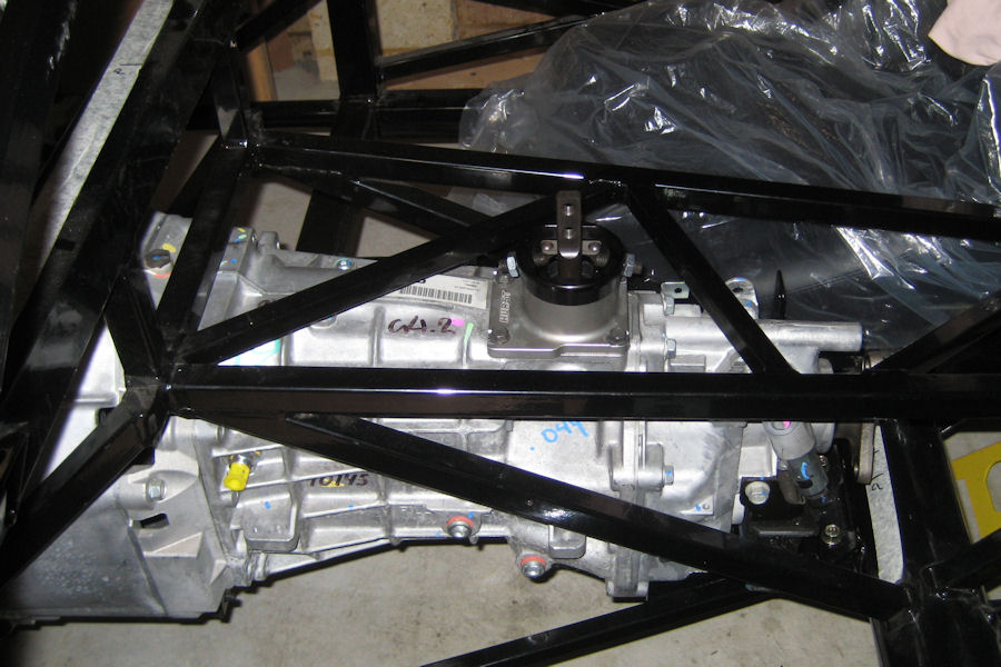

Next step of course was to get the LS3 and TR6060 to reside in the proper place. To start with I coupled the two together, and with the help of a borrowed hoist (thanks bro) I threw the motor in to see how it might look.
http://www.clubcobra.com/photopost/data/500/ffr016.jpg
http://www.clubcobra.com/photopost/data/500/ffr017.jpg
Not to bad really, tho it is a bit tight around the trans in the tunnel, especially over the top.

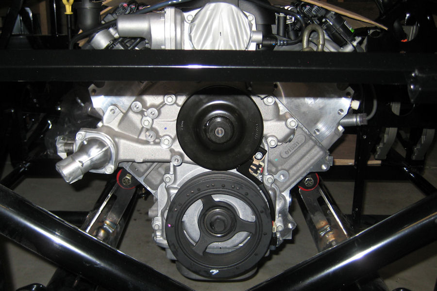

Jethrow 07-29-2011 07:02 AM
Moving on from here tho I did find quite challenging.

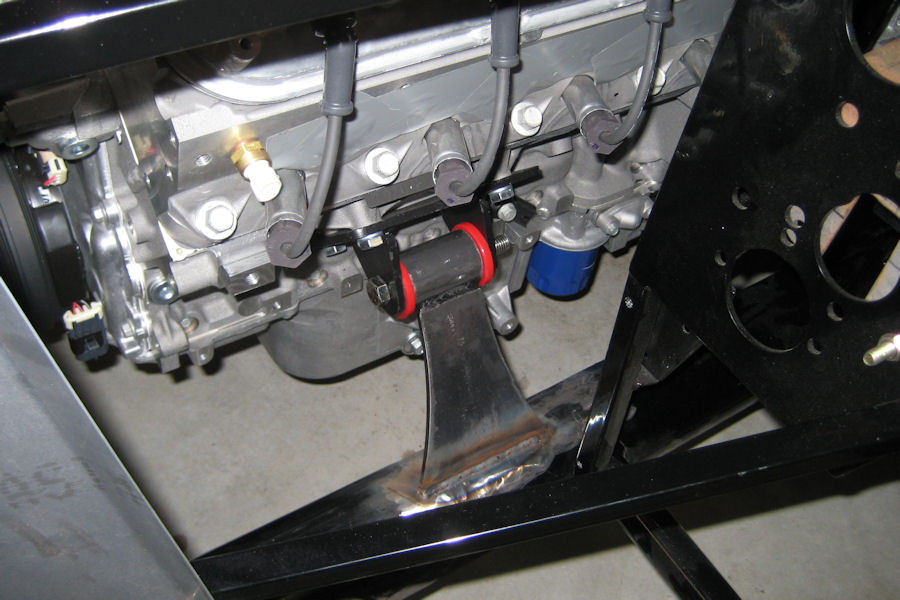

First up when considering mount options I had several things to ponder. Firstly, and this is probably unique to the FFR but they set the driveline up with the engine/trans displaced to the right by 1". This is to provide better balance for a driver who would normally sit on the LHS of the car (US style!).
I was not that keen on keeping that, and wanted to bring the motor back into the centre.
Initially I decided to use factory Holden mounts with my LS3 under the rational that if it works in the HSV, then why not for me. Also worth noting that the LS3 mounts are actually quite different to those from the LS1, being much beefier. Which of course is where the problems started.
I kinda new the LS3 mounts were different to the LS1, but I was not sure by how much, and I could not find a decent photo of them anywheres. So I just jumped in and ordered them, nothing ventured, nothing gained type of thing. Anyway after they arrived (and its amazing how much time I seem to spend waiting for bits!) and I then fitted them up I realised I had a problem.
The factory mounts were way to big. They did not fit down between the chassis rails at all, and if they did, then the would be mounted down almost flush with the bottom of the rails. Way to big. Darn. Back to Mr Google.
I should add however at this point that the trans mount I bought from Holden was actually fine and I have used this for the install.
Back to main mounts and the search. Ignoring the overpriced options I saw on eBay Oz I then found a company called TransDapt who made a generic LS mount to suit engine transplant installs. I bought a set of them (via Summit) and again had another wait till they showed up. Which they duly did. Along with a pretty neat little 1:18 scale 427 SC replica - I wonder how that ended up in there?

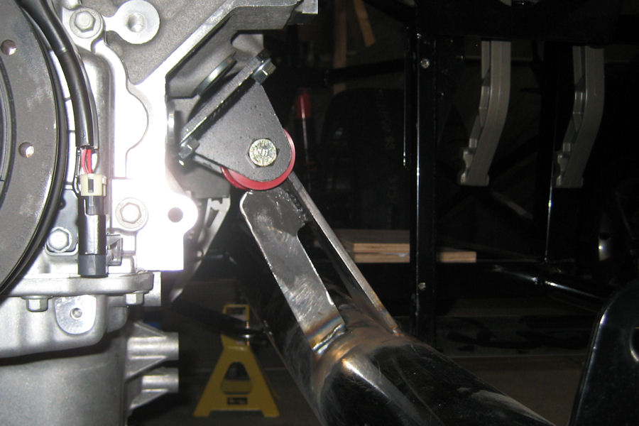

So now with the new mounts in hand I could begin. Firstly I had to cut out the old mounting system from the chassis, and here I must pause to congratulate FFR on their fine welding. It was quite a mission cutting out the old mounts and grinding back the big fat fillets which held them in place. Excellent work with no signs of voids at all.
With the old mounts gone, I mounted up the trans, then setup the motor in just the right place sitting on a wooden block and a few shims here and there to get it level and centred. Next was all about fitting and shaping the new mounts to match the contours of the chassis rails. Once set it up right, I could then weld them in.
http://www.clubcobra.com/photopost/data/500/ffr018.jpg
http://www.clubcobra.com/photopost/data/500/ffr021.jpg
http://www.clubcobra.com/photopost/data/500/ffr022.jpg
http://www.clubcobra.com/photopost/data/500/ffr019.jpg
http://www.clubcobra.com/photopost/data/500/ffr020.jpg

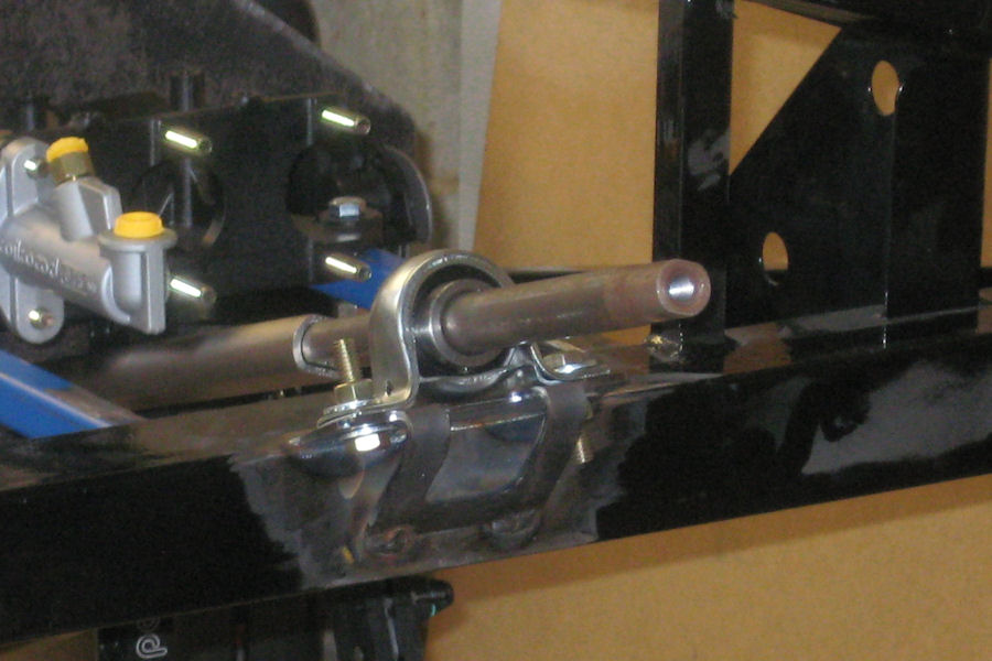

The pics reminded me - I bought a mid-mount shifter from Mal Wood to move the stick to right spot. Thanks guys.

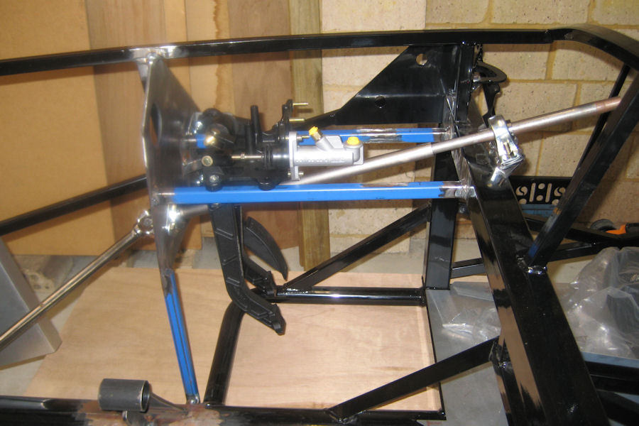

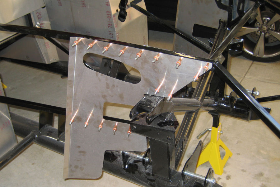

Continuing on from thee last entry, the next area I tackled was the RHD conversion and footbox. As the F5R roadster in LHD from the states, I was on my own here.
I started by fabricating a new steering wheel mount for the right side. I did not duplicate the original design exactly, instead making a simpler mount.
http://www.clubcobra.com/photopost/data/500/ffr035.jpg
From there I set about mocking up various arrangements of pedal locations and supporting structure and after about three goes I finally ended up with something I like.
http://www.clubcobra.com/photopost/data/500/ffr030.jpg
http://www.clubcobra.com/photopost/data/500/ffr031.jpg
The pedal support here is different to the original F5R design, but that is because that design had to cater for using either a Wilwood pedal set or a pedal box from a Mustang. I also took this opportunity to locate the pedals about 2" further forwards to give me a bit more feet space.

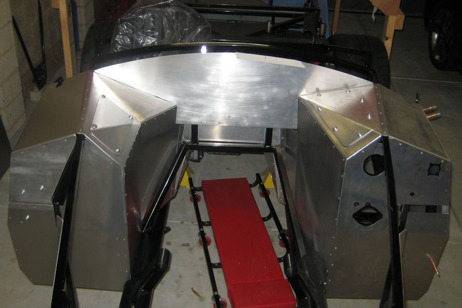

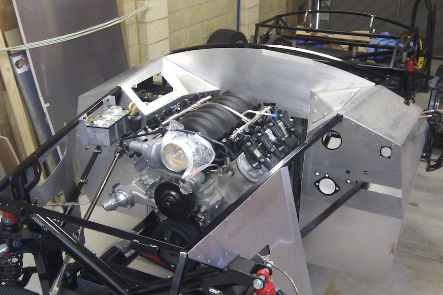

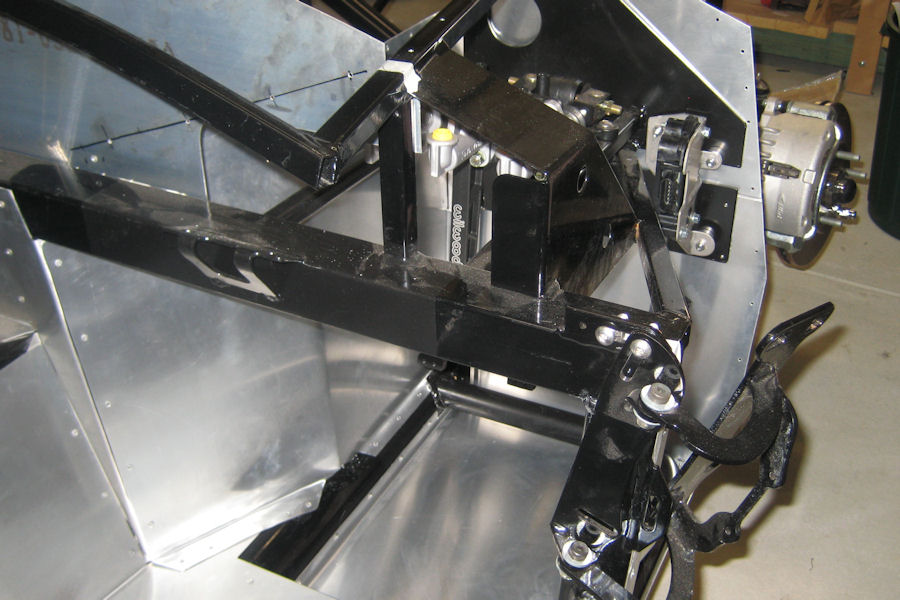

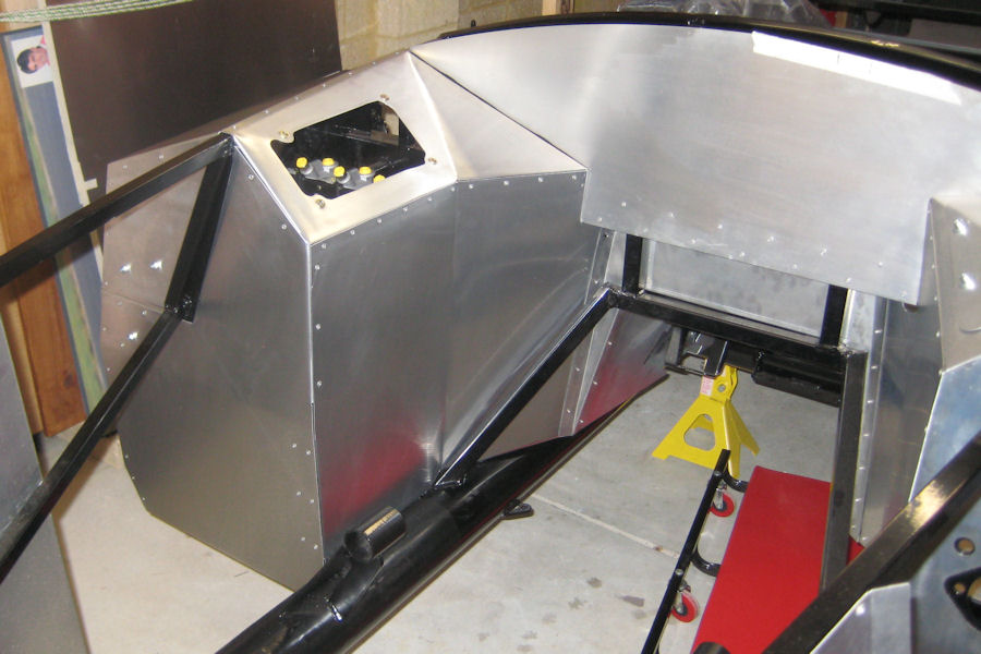

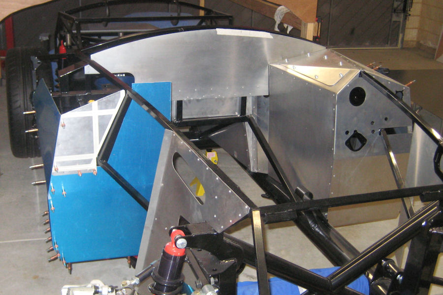

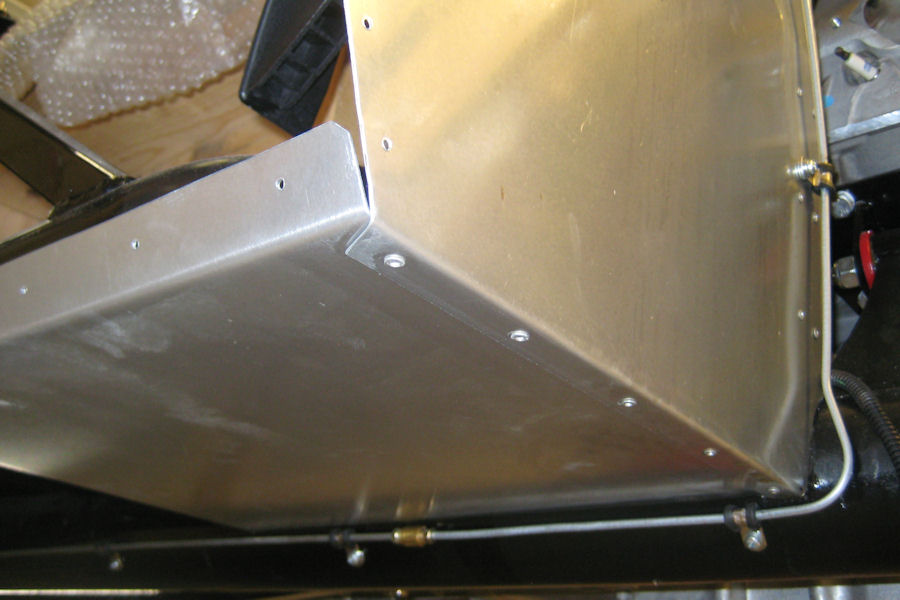

With the pedals now installed, I needed to fabricate new aluminium panels for the right side footbox. As the supporting structure is all different to the LHS, the footbox is not a straight mirror of the LHS.
That being said, doing it all new, allowed me to again create more space by dropping the floor nearly an inch. Setting your feet a bit lower takes your knees just that bit further away from the lower edge of the dash.
I did start off trying to mock the whole thing up in cardboard, but found that difficult as due to the size of the panels it was all a bit floppy. So ended up doing it bit by bit, making one panel, then installing it, then using that panel to help design the next panel.
http://www.clubcobra.com/photopost/data/500/ffr032.jpg
I also widened the footbox compared to left side by allowing it to run up on top of the 4" main beams.
http://www.clubcobra.com/photopost/data/500/ffr036.jpg
When finished, I think it came out pretty good :)
http://www.clubcobra.com/photopost/data/500/ffr033.jpg
And with the other side for comparison.
http://www.clubcobra.com/photopost/data/500/ffr034.jpg

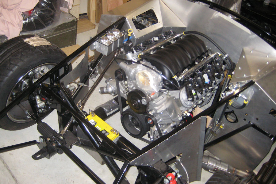

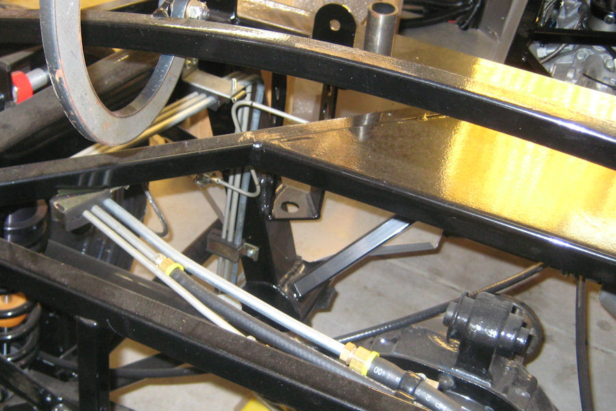

Brake Lines
With the footboxes in, time to put the engine back in and run the brake lines.
The brake lines are all 3/16" bundy tube, with SS braided lines running to the calipers.
http://www.clubcobra.com/photopost/data/500/ffr045.jpg
http://www.clubcobra.com/photopost/data/500/ffr044.jpg
http://www.clubcobra.com/photopost/data/500/ffr043.jpg

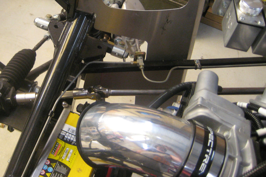

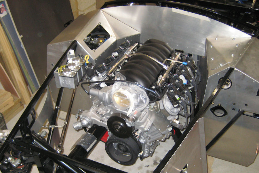

An item of note, I used the CNC TRIPLE MASTER ALUMINUM REMOTE RESERVOIR. I added float switches to them allow for low fluid level detection.
http://www.clubcobra.com/photopost/data/500/ffr040.jpg

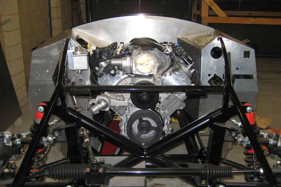

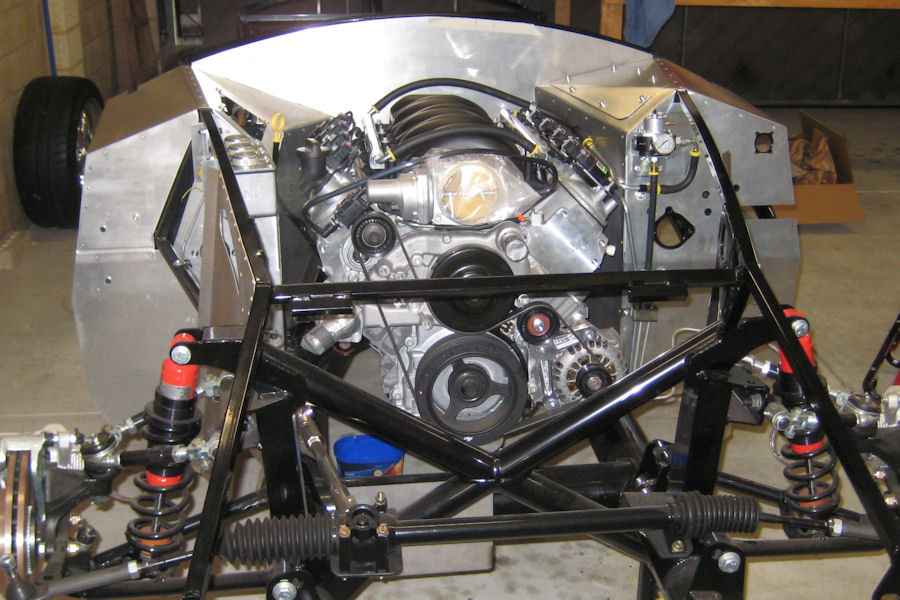

The engine back in, fits pretty good with reasonable clearance (for a cobra).

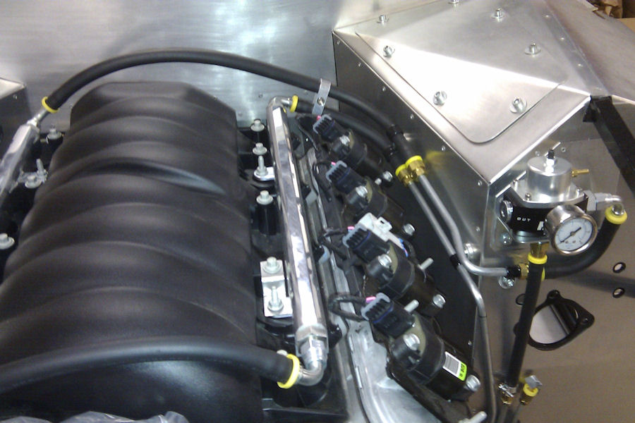

Fuel Lines
Next up, fuel system.
After a false start with the wrong pump being purchased (anyone need a never been used Holley pump? Not used because it requires a bottom outlet from the fuel tank and my tank is a top outlet) I ended up getting a Walpro intank unit.
I also went with larger fuel lines than supplied in the kit going to 3/8 from 5/16 feed lines.
http://www.clubcobra.com/photopost/data/500/ffr054.jpg
http://www.clubcobra.com/photopost/data/500/ffr055.jpg
http://www.clubcobra.com/photopost/data/500/ffr051.jpg
http://www.clubcobra.com/photopost/data/500/ffr052.jpg
I did keep the Holley fuel pressure regulator however.
http://www.clubcobra.com/photopost/data/500/ffr053.jpg
Third line above is for the charcoal cannister - I plan on using one from a VS Commodore.
