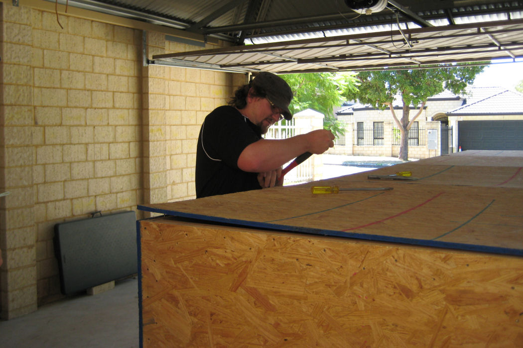

So #7393 has finally arrived!!
I ordered the complete Mk4 kit back in mid October 2010 from the USA and it finally arrived today to my house in Perth. So just a bit over 4 months it took. Not too bad I think.
Big thanks to FFR for making the kit, I think I am really gunna enjoy this. Also to C8Freightworks for organising the shipping. Really these guys were very helpful and did a great job in spite of me constantly bugging them for info and updates.
And there is also another couple Perth lads who also have these cars, thanks in advance to them for all the help I know I will be seeking, along with the help to date.
And for some proof, here are the pics
This weekend I will finish unpacking and start some inventory. Plus try and re-organise the garage so it all fits in. Wife has had the Pajero kicked outside, but gotta keep room inside for the clubby!

is that crate made of treated lumber? i was told Ausi customs won't recieve shipments unless the packaging is made of treated materials.
They will receive them but they require fumigating which costs a fortune!

Congratulations! Now the fun begins, and is only topped when you drive it for the first time. That gel coat looks pretty nice. They say it saves a huge amount of time in body work. Please be sure to inform us your thoughts on that as you proceed with your build thread.

Imported timber packaging must comply to ISPM 15 international phytosanitary prevention convention.
It can be treated with either Methyl-bromide, or heat treated with the core reaching 65deg for 30 minutes.
Only certified sources of material and packaging suppliers are permitted to supply, the timber / product.
The finished crate and its components will be stamped,
If the product comes into Australia without this stamp and certification papers it will be quarantined and you will be up for de-vanning, unpacking, fumigation and destruction of packaging materials which may also include any soft furnishings.
In a previous life i managed a timber packaging business in Melbourne.
Forgot to add, plywoods and particle boards are exempt as by the nature of there manufacture they exceed the requirements and are there fore exempt.

I'll bet levering off that lid on the box was suspensful
We'll all look forward to the progress, it will be interesting to see if the kit goes together easily given that these kits seem to include every nut and bolt. It'll save you many trips to the local hardware guys.
