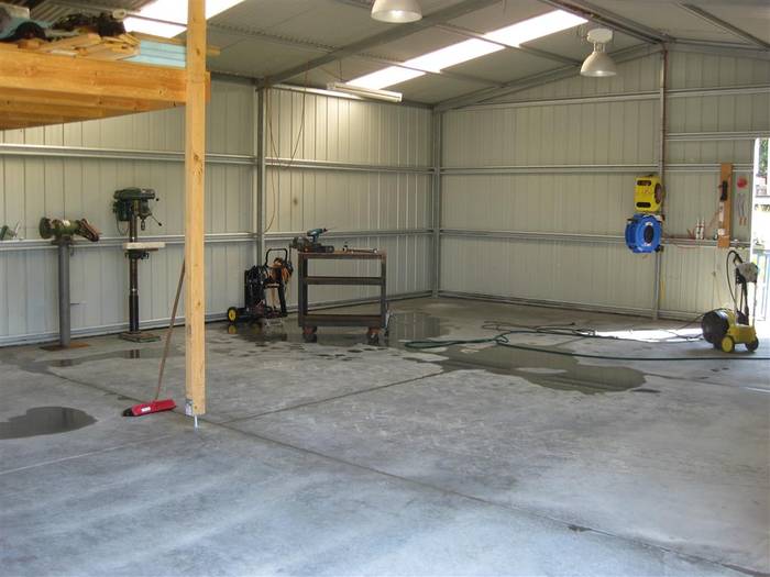

Not much to report since bringing the cob home, other than I've made myself a dolly so i can move it around, started collecting and cleaning / re coating some suspension drive train bits and pieces, but mainly focused on getting "THE SHED" up to scratch.
Learn't my lesson restoring the Fergie you see in some of my pics,
So in goes the concrete floor,
Gents turned up yesterday, leveled the floor, dug a footing pit for the hoist, layed some plastic liner, and installed the reo,
[IMG][/IMG]
Cobby sits under a tree for a few days, concrete goes in tomorrow.

On a another note, started moving back into the shed today, floor is spectacularly smooth, I'll leave vehicles out for another day or two.
