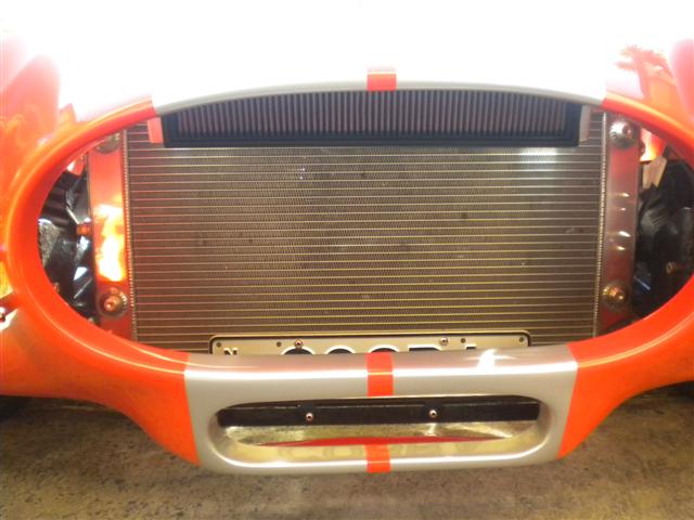

I have fitted an anode in the side of my alloy radiator. Not sure if it works, but I think it is a must with alloy engines. My last radiator only lasted thee months, even though there was no sign of a stray current....
Anodes are available from Summit.
http://www.summitracing.com/parts/FLX-32060/
Ben

In the pic above you can just see the anode sticking out on the left side of the radiator half way up.
I can't remember what the thread size is but it was not hard to make up a threaded boss to weld in.
Ben
