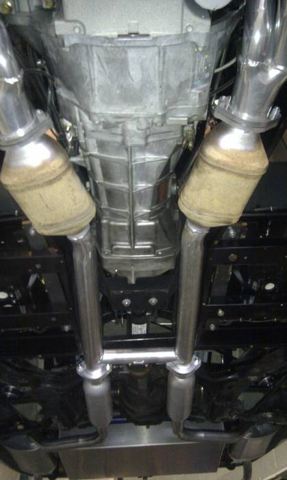

TL, sorry to hear the bad news. With the Harrison you may have to go with VZ cats which are triangular and just fit up beside the T56. The VE cats are bigger again and not straight through as they are fitted right below the exhaust collector in the Commodore. They have an elbow at one end which makes it very hard to fit under a Cobra.
Here is the underbody of my car with the VZ cats and skinny exhaust fitted last week by Yarra Valley Exhaust. The cats are now the lowest point on the car.

T.L. 04-12-2011 01:14 AM
Sambo,
I see were using the same exhaust shop!!!.
I'll see how I go as I have already found some VE ones, and well fit them in somewhere near the top end. I use to work in the exhaust arena a while ago and it comes in handy every now and then.

That's the best under car system I've seen. I can't believe I got through with one of the "loner" exhaust systems going around. This is what I turned up with......
