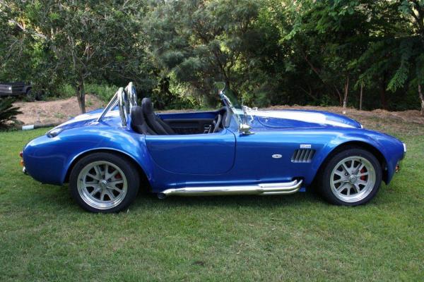

Modena 05-27-2011 05:11 AM
good looks - it could be just the photo angle, but they look like they may be a little short?

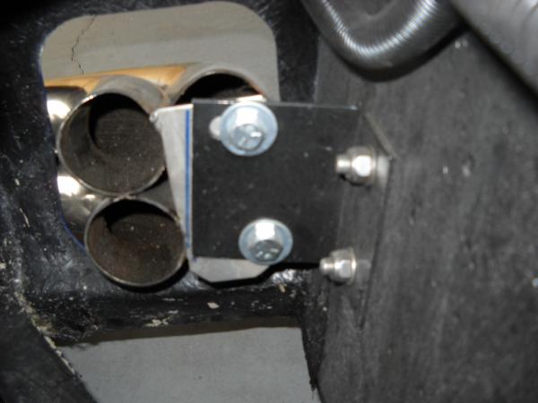

What is the diameter of the main pipe Greg? 100? Also I guess that they have muffling material in them, whereas the Harrison's one would not. 48lbs is not heavy. Any pics of the attachment plate on the chassis inside?

The fixing was a challenge......I'm too embarrassed to take a pic of the temporary bush mechanic method that I employed, only to say it involved a hose clamp and fencing wire:eek: Fortunately it is out of sight down there and only I know ;)
It's solid as a rock though!
To do it neatly needs welding and fabrication, a job for later on with my mates mig.

Yeah about 4" short of the end of the sill.....no big deal for me. I wonder if the factory five cars that the pipes are off are shorter.

Good answer all round Greg. Others may have some pics of the fixing plate (or similar) for the pipes. I am sure many would be interested.

Mine were made through Warwick and am very happy with them. It would be a benefit if you specify what length you would like them to be be as I thought mine were a tad short (my chassis is also 100mm longer) but I don't notice it anymore. The attachment plate is a short length of wide aluminium angle - the front two tubes accept a threaded bolt and the bracket is attached with bolts into the front wheel arch. I have attached the example photos from Warwick but the brackets came with a better finish than shown. The use of spacers allow you to position the pipes where you want them. I allowed a bit of room between the side of the body and the pipes so that small stones can fall through but some of the larger ones get caught.
