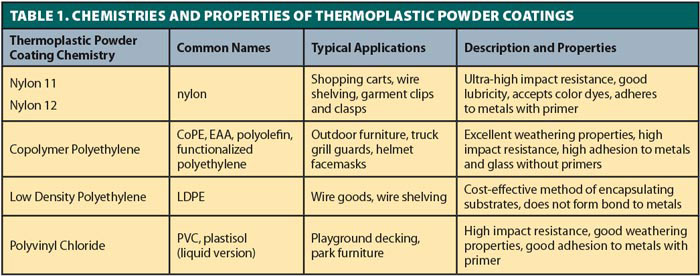

Mudflaps!!?? The side pipes are the mudflaps. I was looking at the thermoplastic powdercoatings (see Rob's post above) and they look the toughest for stone protection.
http://www.pcimag.com/IPP/2006/08/Fi...ekTable1LG.jpg
If this does not check out on Monday, I think I will going the way that Craig suggests.
