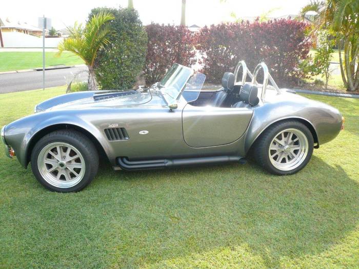

Rather than hijack Hogster's thread, I am thinking about fitting some side pipes. They would be entirely fake, as I have an underbody system, and I wanted them to be simple and matt black. They are there for some degree of visual effect obviously, but also for stone protection. Something like:
Are there any others with similar setups? Also, for a single pipe as shown what diameter is best (80-90mm)? Finally, I can get them fabricated locally here by a mate, but I was also thinking about weight. Could they be done reasonably in aluminium?

I went for the single pipe look and used 100mmm Stainless. The difference is they are LIVE .

Seriously tough look BJ. Like the single pipe look.

I would actually be surprised if there were too many fake "single" style pipes out there. The more correct look is the 4 pipes exiting the guard with the collector on the outside. The single pipe is probably a simpler setup if active - however if you are putting them on for "the look" only, I would go the more correct style. My one cent worth.

There are a few, but you are probably right Andrew. I like the simpler look as in IMG_1427 | Flickr - Photo Sharing!
And also with the collector pipes showing, Mick's looks pretty good and not too bulky
Still interested to see if there is any reason that this can't be done in aluminium.

If your going to do it Merv, keep the 4 into 1 look---Mic

I cant see any reason why it cant be done in Alloy. But the following come to mind:
- Alloy dents much easier and might not hold up as well to rocks and kids standing on them.
- If you are using matt black, the paint probably wont be as durable as if paint on steel due to difficulty bonding to alloy.
Otherwise there is no reason why you couldnt save the weight.

Thanks Liam - yes someone else also said that today. The ally would pit more and be less likely to show adherence with the coating. Steel it is. Getting some estimates this week on 4 into 1 system and single pipe.

Stan, the ones I have seen that are quite chunky and made of thick steel, chromed or stainless and felt quite heavy. Someone may have a figure on that. I am now thinking that I will go for a thinner mild steel with a simple pipe, or even a smaller 4 to 1 system, if necessary. I was also trying to reduce the bling effect as that seems to suit my build better. They do reduce stone chips as well.

I can understand them being fitted if running live (easier and cheaper) but if your fitting them purely for "the look" then unless your car is a 2000 series FIA that had the small single pipe that popped up from under the sill and ran down the side, then any single pipe will not only be fake, but really look fake.
I realise everyone has different tastes, and yours is obviously one that does indeed like the look of a single pipe.
In regards to what material, well your adding weight anyway (since there fake) so a couple of Kg difference between a thin wall steel of thicker wall alloy will be marginal (I doubt you would go with thin alloy as it will dent easily)
