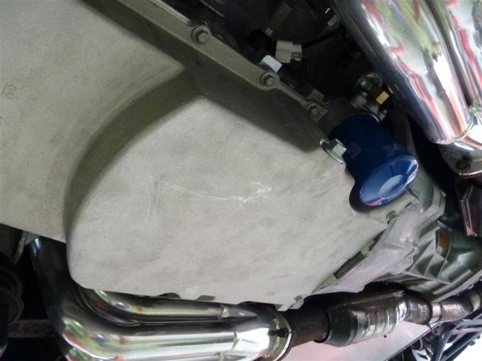

For reference, as i am doing the engine mounts right now, should i go off the bottom of the T56 bellhousing as the lowest point or does the short filter sit slightly lower?
Krait 06-12-2011 02:01 AM
Looks like a good deal.
The short filter sits about level with the sump.
http://www.clubcobra.com/photopost/d...93_Medium_.JPG
Zedn 06-12-2011 05:30 AM
Thanks for the pic. Its a huge difference in depth from the LS3.
