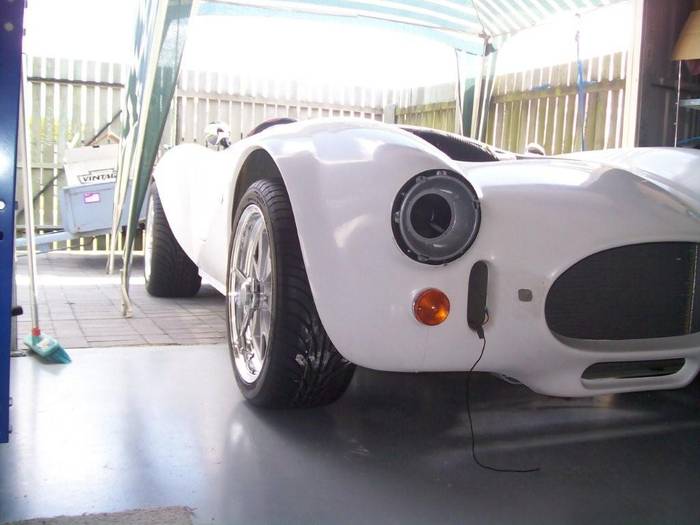

For those discerning folk out there who have chosen to go with a Chevrolet engine in their replica, particularly a Harrison, I have a question...
For you Ford guys, NO there is Nothing wrong with the motor, I am writing to ask if anyone had hassles with the engine being too low, more particularly the sump? I have the sump at about 90mm or less (after a lot of winding up the coils) and wondered if anyone else had the same problem?
Am I just going to keep winding up the coil springs? There is already quite a gap from the top of the tyre to the guard.
Are there any dry sump systems for the L76???

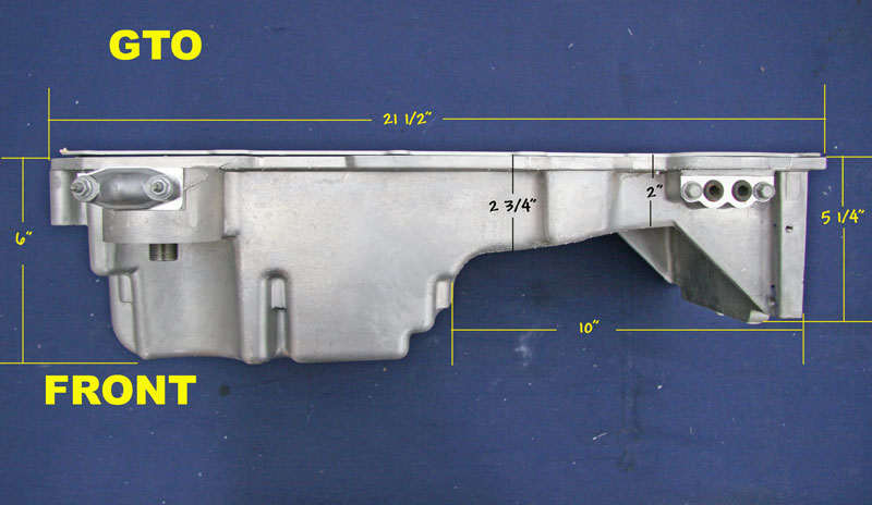

OK, Here's some useful data.
This is the Commodore sump with it's reservoir at the front. You can see it hangs down nearly an inch below the bellhousing flange.

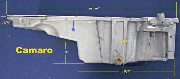

This is the Camaro/Firebird sump. It has a rear reservoir but it also hangs nearly an inch below the bellhousing flange.

This is the LS2 Corvette sump. The LS1 Corvette sump has wings on the side and presents it's own clearance problems in some cars. As you can see the bottom is flat and flush with the bellhousing flange. This sump should gain you nearly an inch of clearance over the others.
