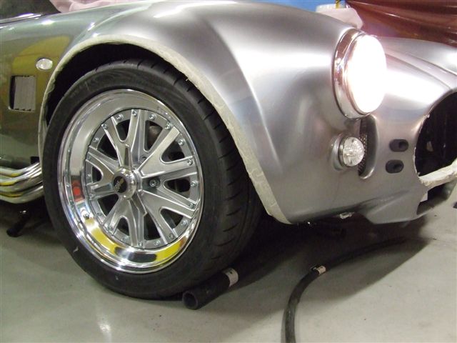

i have just had a go at uploading pictures for the first time so if look at them in my prifile you should be able to see two shots. I hope to put more up now i think I have sucessfully done two.
As for tyres i went with Kumho ecsta XS in 18's as I found very few tyre options in 17inch size and width I wanted so felt like I had to go to 18's.Tyre size as follows with prices paid plus freight on top. 245/40R18 KUMHO ECSTA XS 275/35R18 KUMHO ECSTA XS

boxhead 07-13-2011 07:37 AM
Look good Scoob.
http://www.clubcobra.com/photopost/d...9_July_007.jpg
http://www.clubcobra.com/photopost/d...9_July_006.jpg

Thanks for the feed back on the pictures Box head , I just can't wait to drive the sucker !!

Scoob, I love the look of the outer rim used on the 18" rims, they're just great. The centres are the same as used in the 17" rims. A guy I know here in Adelaide has 18" OZ Wheels on his Cobra but with about 3" on the front and about 6" on the rear. They look magnificent. I asked OZ Wheels what sort of cost would be involved to use my centres to make a set of 18" wheels and he came back to me with a whopping $2400. I figured for that sort of money I'd be better off getting 17" knock on's from Vintage wheels and adapting them to my front end as Aussie Mike has. I haven't dealt with OZ Wheels for about 18 months but they were still OK back then.

I agree with you Mando, the 18" rims on 17" centers look good. The angled step rather than rounded from the center to the rim looks much better.
http://www.clubcobra.com/photopost/d...09wheels02.jpg
I probably could have added another 1/2" of dish on the front but I don't like the look where the edge of the tyre is right near the lip of the guard. I like the tyres to tuck in and not rub anywhere.
