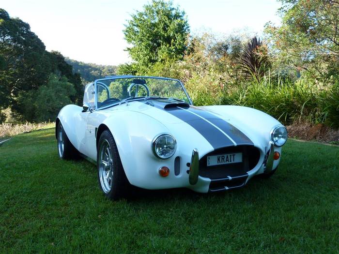

Krait 07-14-2011 08:35 AM
My front wheels are 17 x 8.5 with 5.00 backspacing. Am pretty happy with the way they look.
http://www.clubcobra.com/photopost/d...78_Medium_.JPG
http://www.clubcobra.com/photopost/d...82_Medium_.JPG

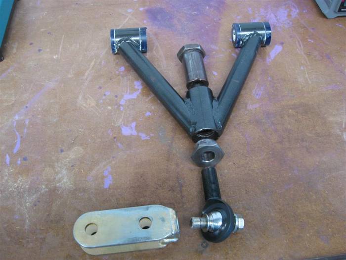

DaveW 07-16-2011 04:45 PM
Is there more to consider by shortening both upper and lower control arms than steering rod end length and potential shock mounting changes, does anything else get altered by just moving the whole assembly inboard by an inch or so ?
How are things like "ackerman" angles or bump steer affected. ?
Upper Control Arm - Front, Chop an inch off the Heim joint end of the arms plate the end, shorten the adjuster lock nuts.

ptrefry 07-17-2011 04:49 PM
Dave i considered going down that road , but found turning new hubs to be a lot easier and then didnt have to worry about bump steering problems.
