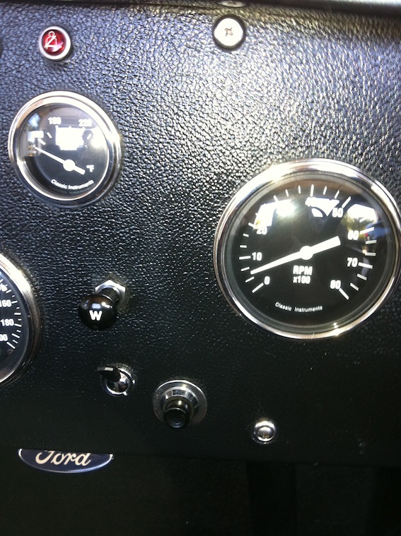

The Cole Hersee switch was available locally and they are a fine product. Very sturdy and if I was building now I would be using them in preference to Lucas, where possible. I have a period knob fitted (from my old MGA) while waiting for one from Cobra Restorers (if USPS ever delivers, they seem to think overseas means Canada ..).
http://www.clubcobra.com/photopost/d...y_switch_1.JPG

Mick, yes the "ON/ON/ON" configuration. The Cole Hersee switch that I got had almost the same set up as my Lucas original toggle (6 pins). It had a Park, Slow High and Battery connection/s. I have tested it very way possible and all seems well. My motor is not a Lucas original (an improved copy?) and has a slightly different wiring set up.
