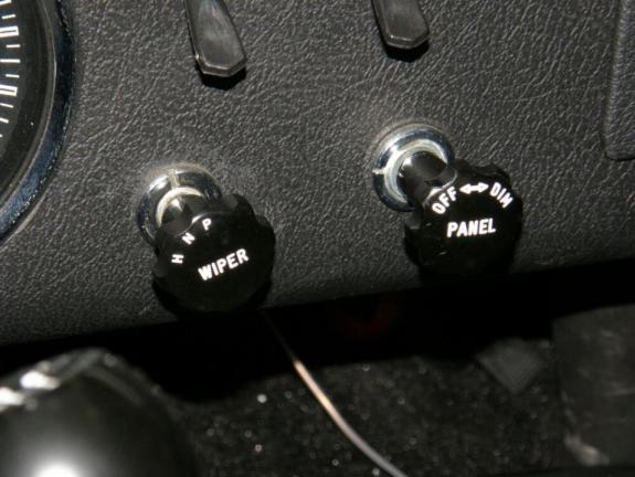

Where can you buy rotary wiper switches, similar to the OEM ones I believe, (below) for Lucas two-speed wiper system. I have looked through the usual sources at AES, Europa and Finishline and didn't see these.

Most of the ones here were white. Wonder where they got the ones in the photo above?

Really Liam's suggestion of the hot rod one (WIPER SWITCHES UNIVERSAL 2 speed and washer funtion | eBay) seems cheapest with a knob fitted. The ones pictured in the first post are from and ERA and are not available separately, I believe. Lots of fluted knobs around in yacht shops and electrical stores.
