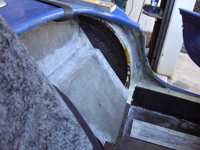

Hi my friend Peter has purchased a near complete Cobra kit car, but he is having real problems registering it. The car has never been registered, or fully engineered. Previously it must have been inspected by an unknown engineer who gave a hand written list of things needing fixing without any reference to who he was.
The Chassis has been stamped with the following number - 6E9P01RTAV1VM0001. The RTA doesn't know this number, and has told him the car will probably never be able to be registered.
He rang an engineer in Frankston area, and was told he was not really interested in looking at the car, and he would have no hope of registering it without knowing the kit manufacturer.
Can anyone help identify this car kit from either the Chassis no., or the photos i will attach, or give some advice on how to register his car. He believes it may have Toyota Crown front and rear ends with fabricated mid section.
Any help would be greatly appreciated, as he is feeling a bit down and feeling buying the car may have been a big mistake.

Looks like a crown chassis - and possibly the scariest looking build quality I have ever seen. Some of the senspension components look like they were hand beaten out of scrap metal - or even cracked (third pic from bottom). I hope he didnt pay much - Might be good for parts, but I wouldn't feel safe driving in it. :o

To be honest I do not think that car belongs on the road.
The car will need a lot of work to be safe.

Basically, your mate is looking at the start of a build not the end.
There are a lot of kits in this condition out there - people started building, it took longer than they anticipated, the rules changed, some of parts they've got wont be allowed any more - the wherewithall is not there to re-do and complete.
His position is now similar to someone just acquiring a kit from a supplier - has some useful parts, some can be made to work - others not.
Probably not what he signed up for.
Frankston Victoria? (only Frankston I know of) Before he gets too despondant call Enkelman's and arrange an appointment to see if the project can be salvaged

If your friend wants to do anything more than look at the body (including registering the vehicle), then yes he has made a big mistake. Sorry, but it is what it is.
It's worth a discussion with Enkelman, but when they see the photos or see the car (!) in the flesh, I would be prepared for heart-ache.

That chassis number looks very much like a number supplied by RTA authorities, most have the state held within the vin(mine are the 7th & 8th characters.
Only kit I remember running the crown chassis (shortened crown) was some early G-Force cars, but the body does not look G-Force to me.
I would be checking more on the vin number you have, as most states do not issue a vin number until the car passes engineering.
And then there is also always the option of club Rego.
But I would first be having it thoroughly inspected by a workshop you know and trust, as driving it may well be taking your life (and other road users) in the hands of the gods.
Good luck with it, and hope it does not cost too much to make safe.

There were many Cobra kits of varying qualities back in the 80's and into the 90's run by guy's thinking they could make it big by becoming Cobra kit suppliers, but did not survive and only built a hand full of bodies or incomplete kits. This led to more brands than most people realise. This was in the day when using modified proprietry chassis was common, ie 356's on cut Bettle chassis, Pervis Eureka's on Beetles, Corvette replica on HQ ute chassis, and cobra's on Crown chassis. This is the way the kit car industry developed. We still build with coprimise by adapting best we can, proprietry suspension components because the cost to engineer and approve these bits is prohibitive to most.
This kit looks bad because it an amalgamation of new and old structures and what appears to be backyard welding and finish quality. And what also looks like another 20 years of road patina. Doesn't mean it's a death trap but certainly may struggle to meet today's more stringent requirements. Whether a lot of TLC is worth it, is up to someone like Enkleman's to advise. WA seems more leanient in the registration of this type of aproach.
This IS a Crown chassis, and is not modified in the traditional way. It was not common to add the steel framing in the engine bay with steel footboxes. Having said that, as i said previously there were many aspiring suppliers, and I have not seen them all, though I have seen many. The way the chassis has been modified is not the way G-Force did it. It was common, however, for the builder to modify one themselves.
There are differences with all kit suppliers bodies that can help identify them, however it is difficult from those photo's alone. You could buy a body only from most any supplier, but some the ones I recall to be either associated with Crown's or more obscure kit's that didn't make it so there were spare bodies available were; starting with the obvious, G-Force, Autostyling, GT Fibreglass, then Silhouette, Boomerang, Lucas, and Irrisistable Replica. Guy's could have also picked up a body only from WE Sports cars (Wooley & Evans) or Classic Glass. These were all mostly based in WA or SA.
I haven't got enough to tell you what it is, but can tell you it's not a G-Force or RMC. Reasons for this, front indicators are not on raised body mouldings, engine bay opening has different edge profile, and larger more bulbous front wheel flare. Some of these features also lead me to believe it is not WE or Classic Glass either. I have only seen one Irrisistable and Silhouette, a hand full of Autostyling's, and have not seen a Boomerang, Lucas or GT Fibreglass in the flesh, however have seen pic's. From all this i'm thinking an Autostyling or Boomerang fits the closest for the guard flare size and no indicator body mounts. Also the edge around the cockpit opening on most are rolled or radiused. G-Force has a larger radius, around 25-30 mm, RMC and I 'm sure WE and Classic have a smaller radius, around 15-20mm. Another identifier can be the head light mounting surface, some use a bezel from a Mini, which is a larger outer radius than MG which is more common/correct. This car seems to have MGB on its right and Mini on left.
