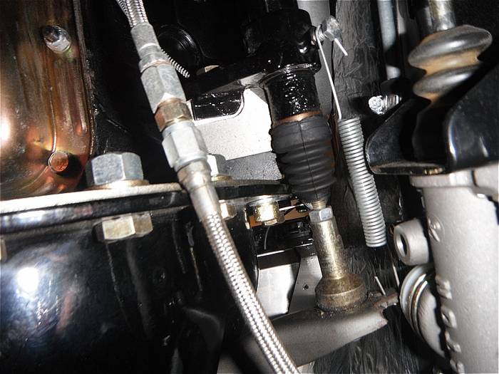

Folks,
Are bump stops recomended on coil over shocks,
just got my QA1's, mounted to chassis to check clearance and it dawned on me that nothing stops it thumping into the end, unless the spring binds before getting through the full stroke,
Also, got 12" springs for the rears, had to compress them 15mm for the spring seat to clear the lower arm, i.e. need 11.5" springs for a perfect fit,
is there a ratio of compression to vehicle lift,
Not sure if i'm thinking this through correctly, but if the springs are rated at 400Lb/In, and ive compressed it say 1/2", what does this mean in terms of ride height?, rear end will weigh about 580kg when finished.

Dave I have 12", 250 lb QA1 rears and the DD501 12" shocks. I found that the 300lb was too bouncy and that I needed the crank up the Rebound damping a fair bit to reduce that. I also was made up some small collars from when I had 10" 300lb springs. That helped to make sure that it all stayed together on full droop. However, with the 12" springs, mine are pretty much like yours, with some degree of preload.
The rule of thumb that I was given was that the shock should be able to move within at least 60% of its travel. Mine do that. The only bump stop I can see is the small "o" ring! My old AVOs had a bump stop but far less travel than the QA1s. The cars sits well at present with all heights (from the wheel arch centre - unreliable) equal. I plan to wheel/corner weights soon and adjust accordingly.

Merv, i think the reason the spring rates are high on the CR is the leveridge action on the shock, the angle is about 27deg off the verticle at ride height, spring compression is about 2.5" to the wheel movement of about 3.8". so a ratio of 1.5 Plus a fair distance from wheel to pivot point.
I plugged the dimensions into the spring rate calculator that was floating around here awhie ago, and came up with an ideal rate of 381 front, 406 rear, almost the same calc as Toperformance in Vic suggested to me of 375/400, so thats what i ordered, at $37 each from Summit, it wont be too big a hit if im out of the ball park.
My main concern was how far the car lifts for each mm of spring tension, must be calculatable.
