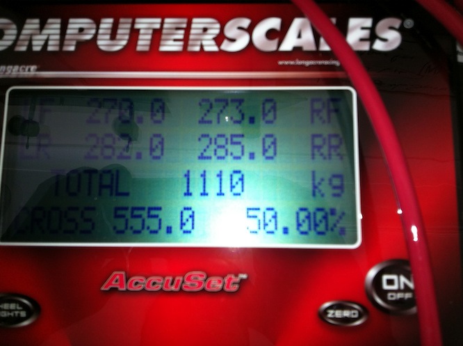

Well the CCC(Q) scales arrived, thanks to Warren, and they were tested this afternoon. Before any adjustments, there was a difference with FR +24kgs > FL and 14kgs for LR > RR.
Overall car weight was 1110kgs with 2/3 tank of fuel.
After disconnecting the HICAS at the rear, I proceeded to start some adjustments, taking the ride height at each point. It is definitely an advantage with a hoist in doing this as you are up and down more often than grandpa's pyjamas, with checks and adjustments.
I have settled at this stage with:
http://www.clubcobra.com/photopost/d.../IMG_02552.JPG
This is pretty close to even L to R (with no driver and I think it would be sensible to do it all again with a driver in) and the optimal 50/50% cross balance. Interestingly, the weight balance has a slight advantage to the rear in my car, reflecting the extreme rear engine mounting.
The website above showing the process for a Honda 2000 is a great help.

Merv .... been waiting to see how you made out ... sounds like you are happy with the handling . My car goes straight as an arrow all the time . I see where Wazza asked about having the driver in the car when you set it up . I always do that since in my case , there is about 88 kilos on the left side ... and it will have an effect . This shop sets up vintage race cars and every car is set with about 3/4 tank of fuel and the driver`s weight in the seat . Alignment is also done with driver`s weight in the car . Most people won`t go that far , but the shop manager used to work for Jack Roush on his IMSA cars and that`s the way they did it .
If you have the time , an interesting experiment would be to change tire pressure and watch what happens to your wheel weights .... it may surprise you .
BTW , my car also has a rearward weight bias ... about 51.9% on the rear . I have an aluminum engine and the ERA is designed to have a slight rear weight bias .
