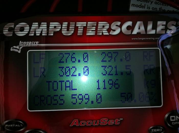

Here is my last reading with No Driver (tools added and RF still to be adjusted a bit):

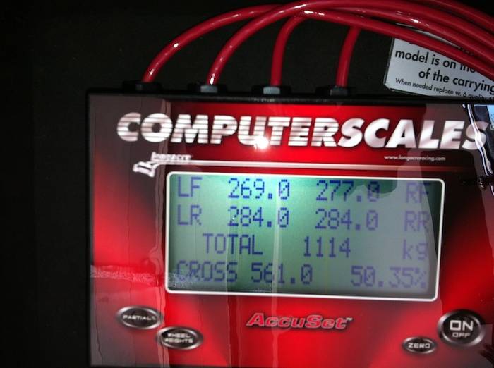

Here is the final reading With Driver (note Cross Balance):
http://www.clubcobra.com/photopost/d...ith_Driver.JPG
Car has lighter, more responsive steering and sharper turn-in both ways.

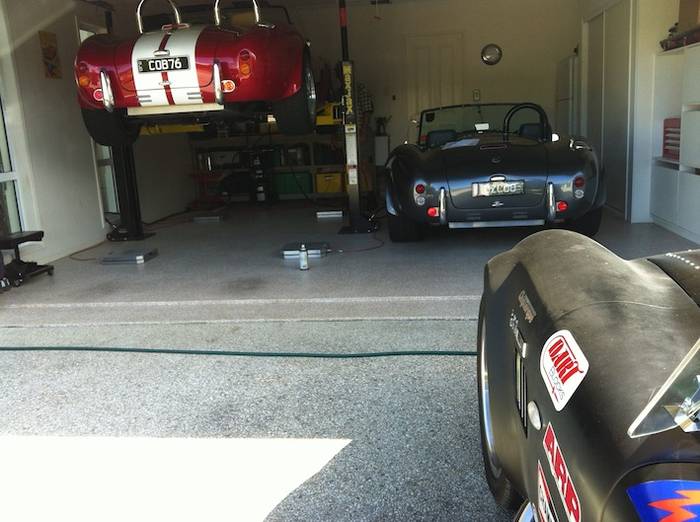

Merv and Sharon 11-29-2011 12:55 PM
The assembly line was in progress yesterday. Now the scales are off to the Gold Coast and Brisbane members! Thanks Warren!
