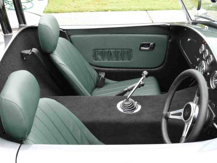

Modena 08-28-2012 07:11 AM
2009 Suzuki Alto
More details and many more pics on my blog http://cobrablog.holnet.net
http://bencobra.files.wordpress.com/.../img_02621.jpg
400TT 08-28-2012 07:07 PM
Nice seats Ben. Good find.

JD I dont know aobut cutting and re-shaping the body, my rear suspension is not together yet. The seats are close enough to square, the front left does touch the tunnel but you wouldnt want to move it any further to the left anyway, its already just slightly off from the middle of the steering wheel. My seats are from a Suzuki Alto. Removing the recliner mechanism (or any other structural modification) would void the ADR compliance
