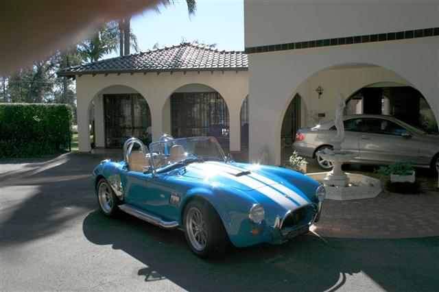

Took the Cobra to Sam's Performance Tuning in Greenacre today for a Dyno tune. 348 rwh (259.5 kw) at 158kph and 532.5 FtLb (722.6025 Nm) of torque at 124kph. Pretty pleased with that. Also included some recent pics.

Lookin good Baz, will you take it to Goulburn?
