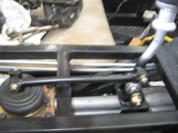

We are looking for some feedback on a relocation forward of the shifter for a Ford/Tremec T56 shifter. The gearbox is behind a XR8 Boss260 5.4 Quad. We do not have the engine in the chassis as yet but from rough measurements we will need to have the shifter between 100mm and 130mm forward to be in the ideal location. Peter R has sent us a couple of photos of fabricated shifters he has made at the factory. The concept looks fairly simple although fabrication of this kind of thing is not something we are keen on if we can find an option.
If anyone is aware of an off the shelf soultion that gives a solid and precise shift it would be greatly appreciated. We have heard a few comments about 2 to 3 shifts issues with the standard shifter and do not want to compound this problem.

That looks like a T5 gearbox in your pics. T56 is a little different.
Here's what I do. It's not exactly an off the shelf solution since it requires a complete strip down of the gearbox.
I've done a lot of them now and worked out the mod back in 2003.
Shift quality is significantly improved from the stock shifter setup.

I am not 100% sure exactly what model the gearboxes in Peter's photos (1st post) are although the bottom one looks like a Ford version T56 to me. Either way our application is definitely for a Ford T56 6 Spd which came out of our XR8 donor car. (It was not the original gearbox in the car as it would have come standard with a 5spd). I have attached photos of our box and the alternate shifter location plate is too far forward to be of use to us. We only need between 100 mm and 150 mm to get the perfect location. Stokesy's post sounds promising and I will definitely drop him a line for some more info as I can't seem to find anything that matches on the Summitracing site?
Garry from DRB said that the front pivot in the top photo which is from Peters' Citric Green Cobra is a ball joint they adapted. I am not sure what type it is but seems an innovative idea. The linkage does concern me a little and I had thought that maybe a dual link (one either side) might make it more rigid and stable but we shall see? We had also considered replacing the original mechanism with an aftermarket one to tighten up that part of the shift but first things first.

That's a T56 alright but the extension housing on the Ford version is quite different to the GM one.
That cover plate nearer the middle of the box is an inspection cover over the detent mechanism and that's where my mid shift comes out. Too far forward for your application.
You may want to look at adapting up a VE commodore extension housing. This has an external shift mechanism that could be shortened to the position you need it. Probably more work than it's worth though.
