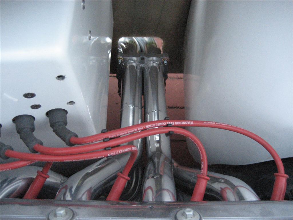

I made a start on my exhaust headers this weekend. Almost finished one side. Decided to go with 1 7/8 pipe. It is very tight, so took ages to get all the bends as tight as possible. I did my best to get the pipe lengths as close as possible but with such limited space it was a bit hard. These will be ceramic coated when finished. I dont have much clearance between the pipes and foot box. Might have to add a heat shield to protect the paint.

I made a separate set of headers for the under car exhaust. I figured i didn't want to make too many compromises with the side pipe headers.
My undercar headers were based on Corvette exhaust manifolds (cut down to fit). They were cheap to buy and tucked in close to the block. Several folks have used them for rego now in fact I'm not really sure who has them at the moment.
http://www.clubcobra.com/photopost/d...B_Manifold.jpg
If you are careful with the routing of your pipes you can make the headers pretty easy to unbolt and remove. I can unbolt mine and take them out through the engine bay pretty easily. I also went with 1 7/8" primaries as they suit my cam and intake combo.
http://www.clubcobra.com/photopost/d..._Headers_2.jpg

The corvette style wouldn't work on mine due to the chassis layout. I also have my motor mounted a fair way back and also the foot boxes quite big. All this adds up to the exhaust going forward and out instead of out straight to the side.
Are your headers stainless or ceramic coated? Also did you make the 4 hole flange or buy it?
Aussie Mike 05-26-2013 03:59 AM
The headers are ceramic coated mild steel. I got the 4 hole flanges from Daren Difillipo in Melton Vic.
