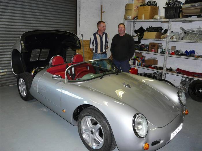

From memory Peter Gillard (engineer: ADR COMPLIANCE SERVICES) had low volume compliance for his 550 spyder he was producing.

I think that his car has 'died'. It was a great one. I looked at it carefully.
It was a very nice car....Pete and Alan in their workshop.....

In a small aside, I was speaking to Peter G the other day, and he is no longer making the Porsche replica as he can no longer source the body - his supplier folded and so he ceased production. A beautiful car, and a great engineer too.
