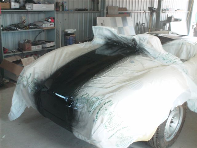

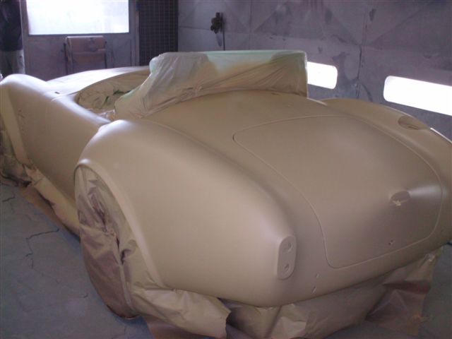

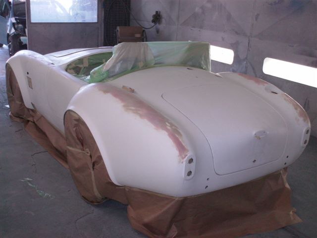

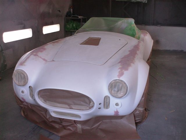

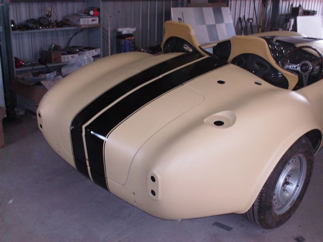

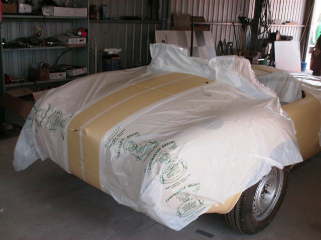

Here is mine all sanded down.
Tinted primer on.
Taped up for stripes, laid out as per ERA website.
Stripes on.
Unmasked.
The color has faded a bit and also the black is really faded or washed away now.
Cruising in 5th
