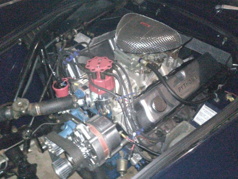

David can you do me a favour. I'm in the process of a new engine going in and I'm not anywhere near the car at present and wont be for a while. The new engine has a 'fast' 4 barrel throttle body going on it and I'm wanting to get an air filter from summit that actually is oval and also pulls air through the top. Before dropping a few hundred can you do a measurement for me please ?.
From the centre of your carby how much room do you have before the firewall becomes an issue ?. I'm in the process of seeing what dizzy has come with all the other parts, I have left all the spec decisions with my engine builder, I just gave him a figure and I trust him totally.
Thanks in advance
Chris L
Thanks in advance
Chris L
Hi chris the center of the carb is 150mm to the bonnet rubber, 300mm to the firewall at the top and about 80mm from top of carb to the bonnet rubber, thats the same block as your current engine with an edelbrock rpm performer manifold and a holley 670

That's the one Michael, is yours 12" long or 15"..............that's the filter I'm referring to.
Chris L

05-02-2013, 03:38 AM
Join Date: Dec 2002
Location: Melbourne ,Victoria- Australia,
VIC
Cobra Make, Engine: Python
Posts: 271
Thanks David, so I can assume a 2" thick filter sitting on your carby would extend to the front of the bonnet lip if it were 12" (300mm) long only just, assuming the mount flange is dead centre of the air cleaner, allowing for 150mm forward/150mm rear.
If that's correct then a 15" filter would extend approx. 40mm or 1.5" under the bonnet lip without fowling the height (80mm clearance/ filter height = 50mm). I'm assuming my new manifold and throttle body combined height is similar to your manifold/carby combo.
Maybe I better stick with the 12" version and give myself a chance , being a little to cute will bite me on the ass, particularly when I cant do the measurements on my own car !!
Appreciate your time
Chris

hi chris i remebered i have a photo of your engine bay from winton if it helps
05-03-2013, 01:15 AM
Join Date: Dec 2002
VIC
Posts: 271
Thanks David, it does help and I'll be going with the 12".
Appreciate you time.
Regards
Chris
